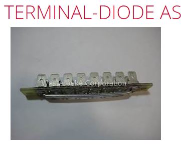

I had a multimeter and the manual with the wiring diagram, but the devices on the Captains Panel are all interconnected and I there was no detailed breakdown of their relationships. There is a "Terminal Diode Assembly" which is a push connector bar with multiple diodes between the different connections. I ordered that and will give it a shot. I would prefer to diagnosis the problem rather than just replace parts hoping one works, but the Mac Race was this weekend so getting anyone out on Friday or for the rest of this week will be tough. Thanks for the tip, I'll let you know if the diode assembly works.
