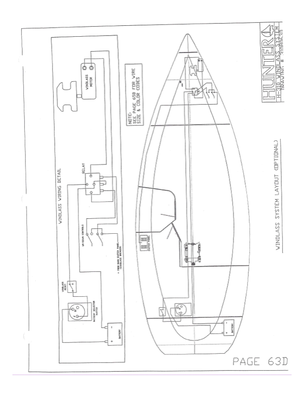

I got this Page from the H310 owner's manual.
Does this match your boats wiring?
Jim...
PS: Note the Battery Selector Switch

JamesG161
Feb 14, 2014
7,770
Hunter 430 Waveland, MS
Using battery switch can you disconnect the alternator from house bank?
This is what I asked.
I think he does not understand his Battery Selector Switch.
I posted the Windlass layout from the H310 manual in my post#12 above.
Jim...
