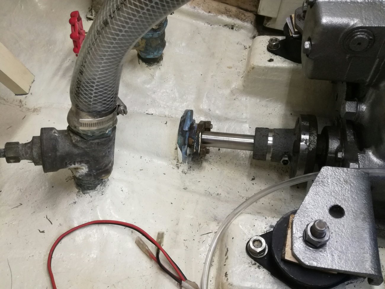

Will add a pic of my shaft set up to illustrate.

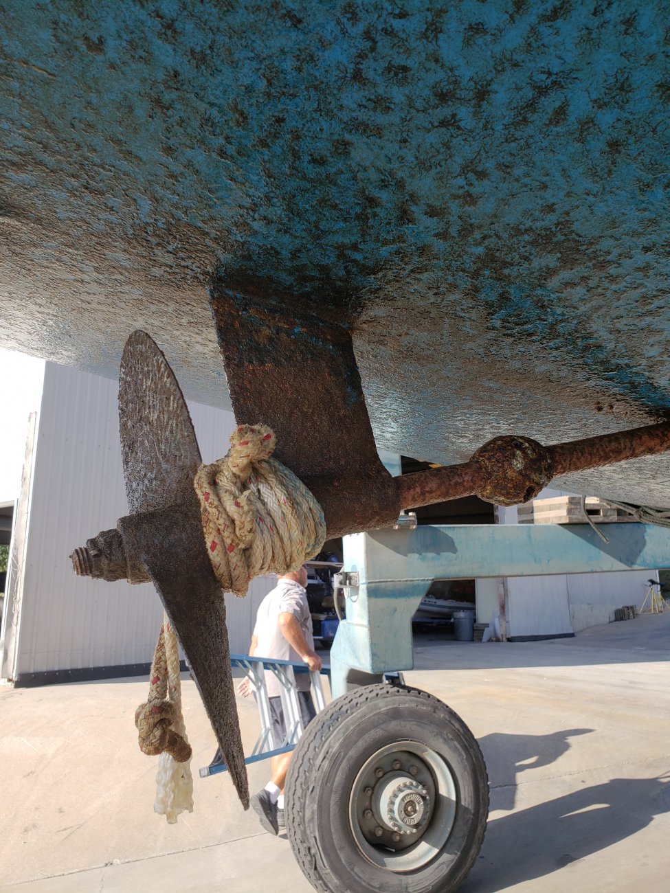

Thank yall. I tried to turn the prop shaft by hand and it would not budge. This morning I had the boat hauled out and found the issue. After this mess was cut loose and had the bottom power washed the engine is running just fine. Thank yall again for the guidance and suggestions.

Who tied that knot?
You might think of an Aluminum Galvanic shaft protections too. Looks like your "Zinc" is NOT.
Jim...
PS :Lake Texoma is fresh water, if my memory is correct.
PSS: Maybe "Gyp water"?

You are correct, it is "fresh water" normally it is very murky but with the recent floods it is even murkier. With goggles visibility is about 6-8 inches. As for the knot I guess you could say it was me, lol. I thought about trying to "untie" it but after a min or so we said to hell with it and just cut it off.

You have serious overall Galvanic corrosion per your last picture.
You should switch to Magnesium or Aluminum sacrificial Anodes for fresh water.
I think I see 'pitting" of the strut, but I am not there.
Jim...

I use the term "fresh" kinda loosely. Per the Water Quality studies the lake is pretty high in Sulfide & Chloride and has a salinity level that is elevated. Its technically considered "brakish"

I did download your picture and ZOOMed in.
It looks like a Calcium Sulfate deposit or what we called "Gyp water" or Gypsum.
I lived near Altus OK, growing up.
Chlorides are not the issue, but the Total Dissolved Minerals or Softness/Hardness of the water.
Jim...

I thought I saw pitting as well on the strut at first glance but once the bottom was power washed off it was pretty smooth and I didn't see any. I honestly have no idea what material the strut is made out of. I know its factory. This is a 1991 Catalina 28. I will email the serial # to Catalina and see if I can get an answer.

For Galvanic corrosion to take place, it does need dissolved minerals in the water to support electrical flow.
I will bet you a beer, it is.
Catalina will not help you. Ask other in Lake Texoma what they use for Cathodic protection.
Jim...

My guess is...
Stainless Shaft
Bronze Propeller
Mild Steel for strut
Jim...

I am concerned about your metal. The picture looks like corrosion. Maybe, it is just mud and will wash off. If not like @JamesG161 suggests aluminum not zinc in non saline water.

I am not sure that is corrosion. The hull is covered with the same “stuff”.
Mine comes out of the water looking pretty bad too, until the bottom is cleaned. I am in fresh water too.
Too bad we don’t have an “after” picture after she was power washed.
