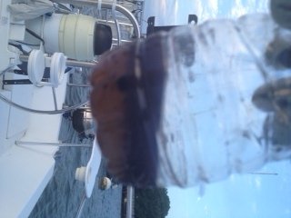

not sure if can't make out the photo however this is what came out when i changed the fuel pump filter. could it just be that there's too much crud in the tank and need to flush it out??
