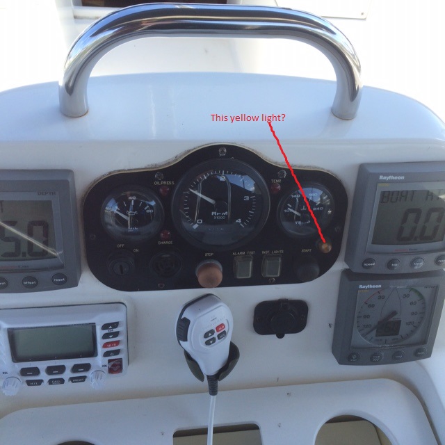

engine panel yellow light

2001 hunter 410 engine panel has a yellow light on the right side. I am new to the boat. I don't know what this light is for? Can anyone give me a clue?

Its not a light. It is a fuse. You need to replace the plastic lense and it will be a clear soft plastic so you can push the fuse if it ever trips.
