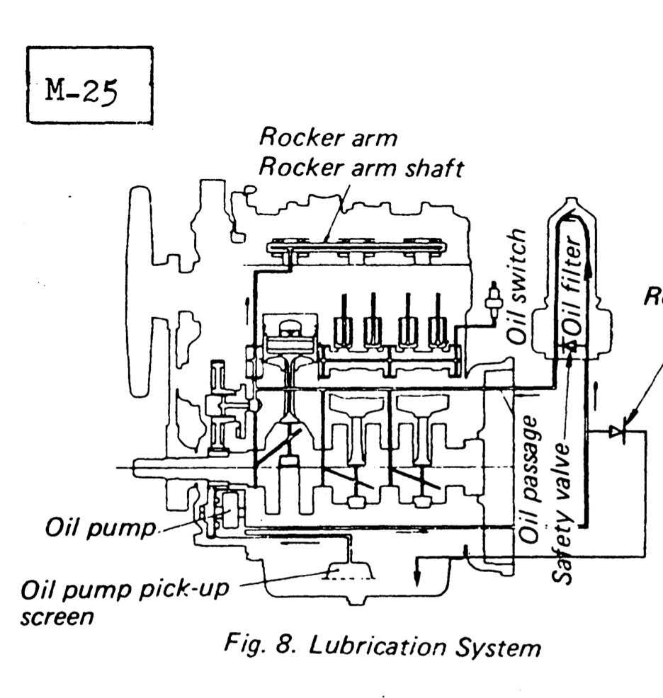

Here is the image in the M25 manual. Which shows it as a sender (Switch).

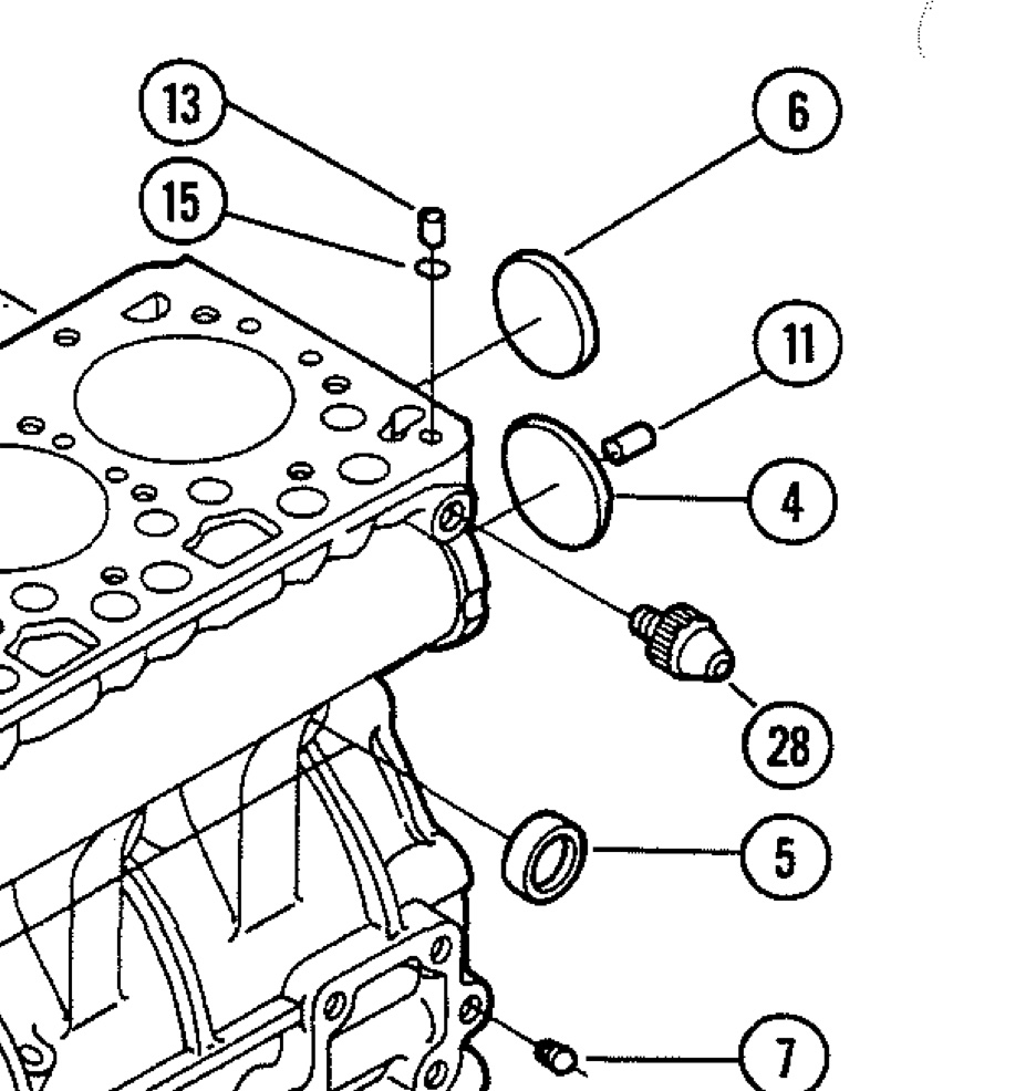

Here is the item (number 28) as an exploded diagram on the engine. Part number is listed as 299964
Here is the same part number 299964 from the previous image.
This part uses the engine for the ground and the wire attaches to the top of the unit. It is not unusual for this connection to become intermittent or fail.
There is a second design also called a "switch.
You need to identify which is on your engine and buy accordingly. Or you can verify that the connections are connected. A habit of disconnecting is normal. I think the two wire connection uses a bayonet style connection.

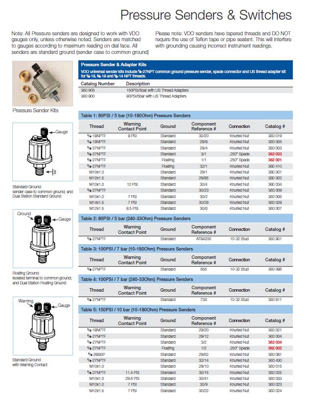

BTW, the pressure switches for Catalina which @jssailem shows in post #8 are described as normally closed (closed contacts with no oil pressure) and what you would expect to find on any engine. Methinks post #3 reversed the idea. It's that closed position which causes the horn to always sound before the engine starts turning over and acts as a test for your LO oil pressure alarm.
Unfortunately, the same is not true for the HI temperature alarm.
Also, the pressure sender which you originally referred to is actually a variable resistance sensor which sends a signal to a meter and shows what the oil pressure is.
