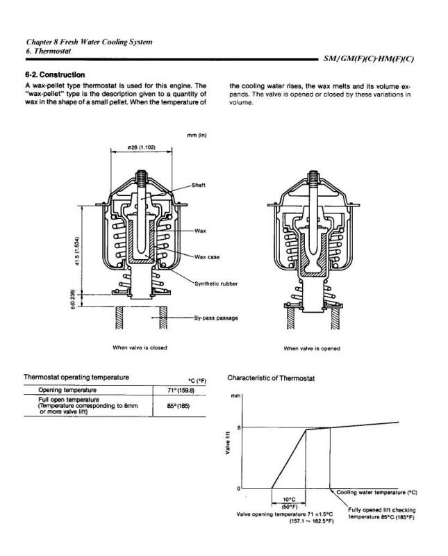

Ralph, how do i determine if the engine is running cool? If after startup, i let it warm up a bit, then engage reverse to load and warm up further, would that be right? I've a temperature scanner so i can measure the mixer elbow and engine body but what temp number should i be looking for? How long would it take the engine to warm up? Appreciate advise.
According to the manual (which I have illegally scanned here), the range is 160-185 F. I seem to run about 175 when cruising at 2700 RPM.
I think if you load the engine for about an hour and then shoot the top of the thermostat housing with your scanner, you should have a reasonable idea of what the temperature is.
Ralph, thanks. I'll check it out.

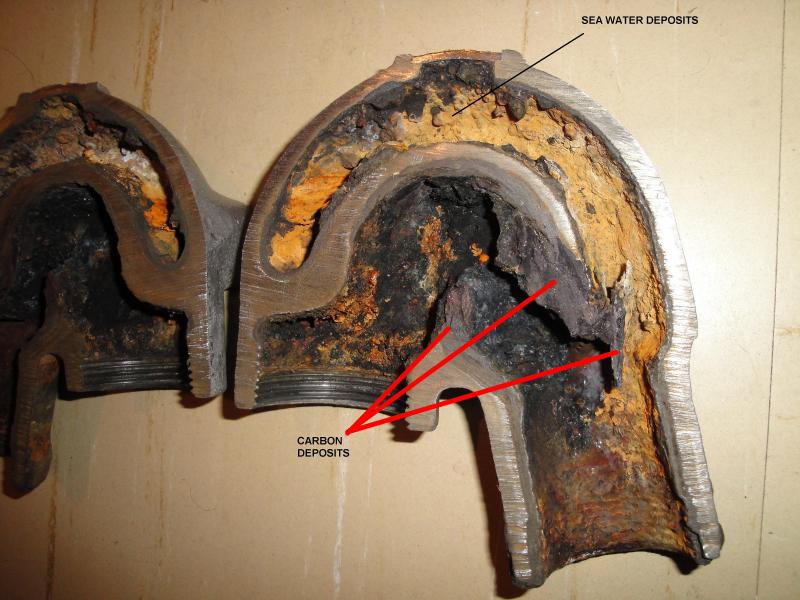

Looking back at your original post and referring to what Petersea has mentioned (you can see how busy I am at this time of the year), I too would have to suggest that your changing of oil viscosities is probably coincidental with some other problem slowly appearing.
Rethinking this, my guess (and it's nothing more than a wild guess) would be the mixing elbow followed by the fuel filters. These little buggers (my elbows at least) are continuously plugging up and the one below (which I chopped up a few years ago) had a gas passage of about 1/4" diameter. Output at WOT (loaded) was still 3,500 RPM and I'm not underpropped nor excessively out to lunch. Don't ask me how it worked but it did. Mind you, it wouldn't be too many more running hours before the RPM would start to drop.
Do let us know how it turns out as this is one of the more interesting problems here.

Ralph, we can rule out mixing elbow as I recently had it decoked. As for the fuel filter ... I must admit I've never changed it for ..years ..:redface: since I didn't like bleeding air from fuel system as it gets pretty messy.:doh:
Alright, I'll bite the bullet :cry: and try changing fuel filters and see if that helps.
