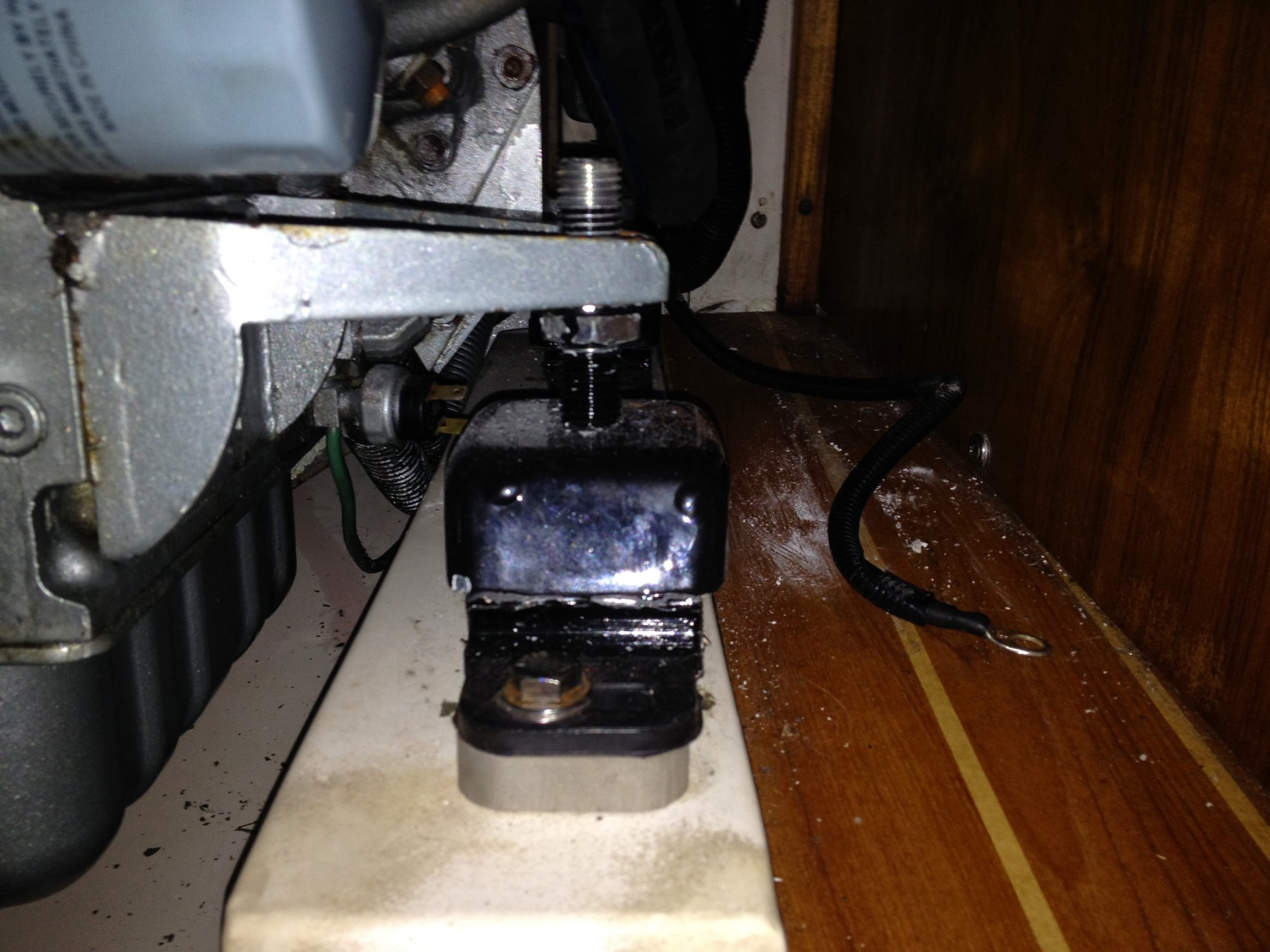

The engine bed on the 310 has a slight flaw. As a result the forward mounts are adjusted near the top of the studs. This hurts the alignment and leads to a shorter life of mounts. I replaced with OEM and put 1 inch spacers under the front mounts. That was around 1800 hours ago and no issues so far.

Did almost the same on my Legend 35. Added a tapered aluminum wedge under my front mounts. Solved two problems: 1) made the height of the for and aft mount about equal, and 2) changed the angle of the front mount to co-planar to the the engine and thus relieving distortion in the front mount. (the aft mount still has some distortion, but it doesn't have room to add much underneath)

JK_Boston ....... could you put up a picture when you have the time and chance. Is there a mount that you can mount and then screw the bolt into the mounts from above. I was looking at cutting the bolts one at a time.
