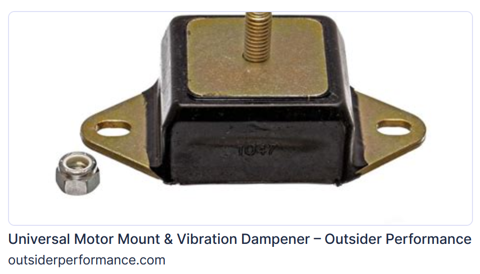

I typed in "vibration dampener tractor motor mount" and got the following results:

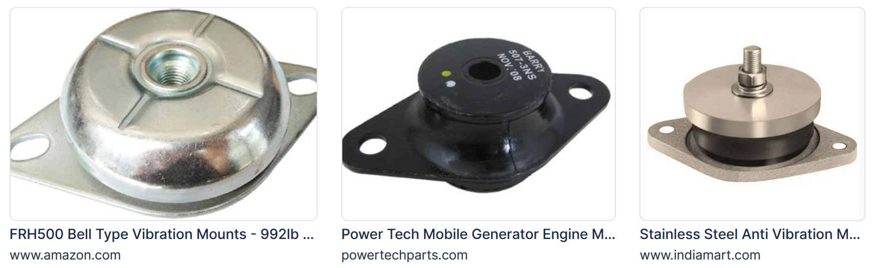

I then typed in "stainless generator engine mounts" and came up with the following. This looks promising:
Leave it to Westerbeke to use an ordinary part and sell it for hundreds more
