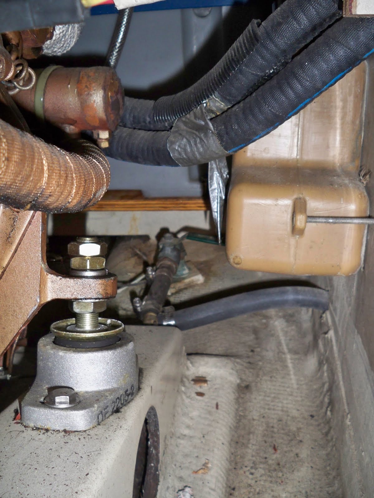

I replaced the engine mounts on our Universal M25 in an Oday 34 several years ago, using the Bushings Inc. DF 2205-2 mounts which were similar in style to the originals. My hope was to eliminate the vibration that is annoyingly pervasive through the entire boat when motoring. At the time I replaced the cutlass bearing, dripless packing gland, had a new prop shaft made and had the flange fitted to the shaft, and mating faces machined. The original installation was pretty well aligned, and I was careful in getting the new shaft aligned as well, so I am reasonably confident the issue is not alignment related. The new mounts made virtually no difference in the vibration however. I am getting ready to revisit this issue and in reading through some past threads, I noticed Maine Sail referenced a Westerbeke enclosed motor mount for the M25XPB (Westerbeke part #40510), and I am wondering if I could use this mount on my M25? I can't find any specifications online as to the mounting hole locations. Most websites list the BI style mount for the M25, but I am not confident buying the same style from a Universal/Westerbeke dealer is going to get me any different performance than I am getting from the BI mounts.

Already done :) I've never been on another Oday 34 or 35, but compared to most other boats I have been on, ours definitely has more engine induced noise and vibration. It will rattle the teakettle off the stove! Last year I rebuilt the exhaust riser and used a silicone hose from the riser to the muffler as well, thinking that may reduce some transmitted vibration, but so far nothing has made any difference.

Two blade prop, vibration all the time, even at idle in neutral, and nothing hitting where it shouldn't - I've had several years to check :)

No smoke other than trace amounts near full throttle - mostly noticeable at night by the stern light and the normal 2 - 3 seconds right after start up. I adjusted the valves last year - they weren't too bad and only made a very slight if any improvement. I have not tested compression, but based on the fact it starts well even in cold temps, I've never suspected it to be a problem. Exhaust riser was replaced last year. I suppose I could have the injectors rebuilt, but again nothing else leads me to conclude that is necessary. Based on reading lots of posts about engine mounts, it seemed like that was a likely place to start but I still haven't gotten an answer to my original question about whether Westerbeke part #40510 would be suitable for an M25 engine?? :)
