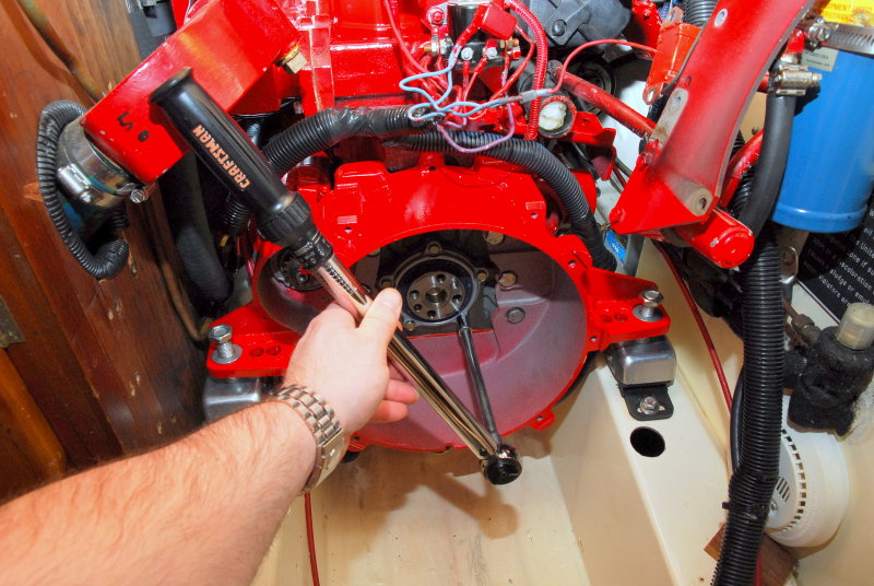

Today I installed the starter, bell housing, new motor mounts, new starter cable, re-wired a bunch of the factory wiring and installed a new rear main seal.

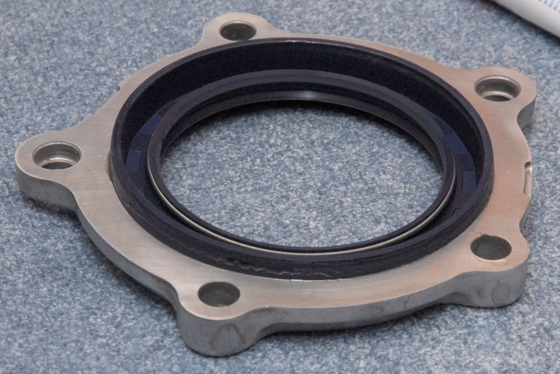

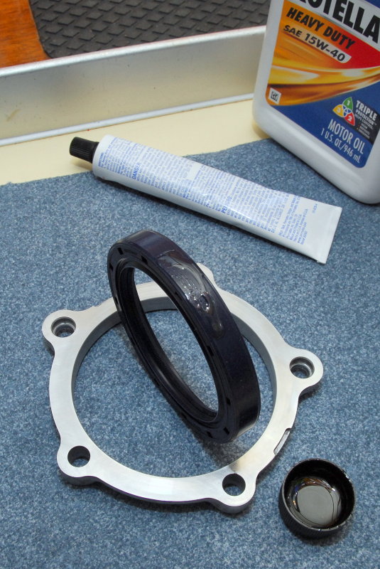

New Rear Main Engine Seal:
Installed In Casting:
Installing the Rear Main:

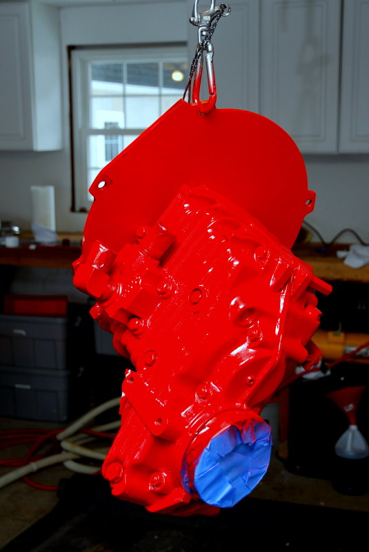

I am just waiting for the fresh paint on the tranny to fully harden before re-installing the PSS seal, shaft and tranny..

Is it really red??
Why didn't you use red paint? ;)
Is it red? I hadn't noticed..:D I must say the factory Westerbeke paint is expensive but it lays on beautifully and is really, really RED! It costs about three times what it should, what else is new, but it really is a good paint..
