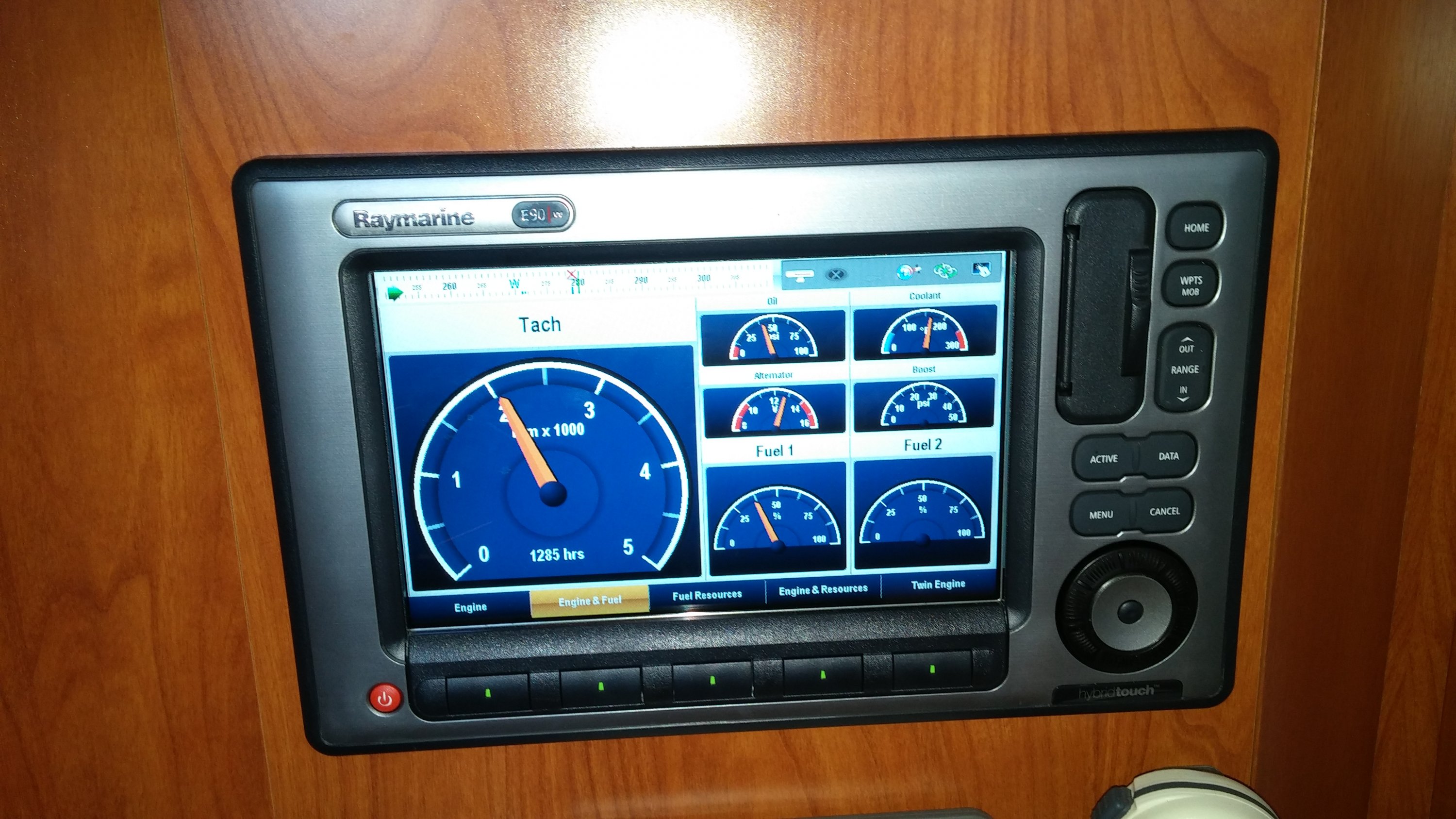

I made a simple modification on my Hunter 50 equipped with a MAS 200 monitoring system. By connecting a NMEA cable from the MAS 200 via a "T" to the Raymarine Seatalk ng bus via a Raymarine adaptor, I can now see my engine instruments and hear alarms at the 2 chartplotters on my boat. If anyone would like directions please let me know.
