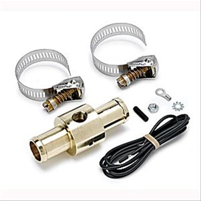

Consider putting the US sender in the outlet hose - thus no inconvenient adapters needed and no vibration fail threat either.
This one is from Summit Racing the hose barbs are .750". The sender port is threaded NPT so you use your US sender. Call Summit to verify your sender threads match their port.
You could even make one.

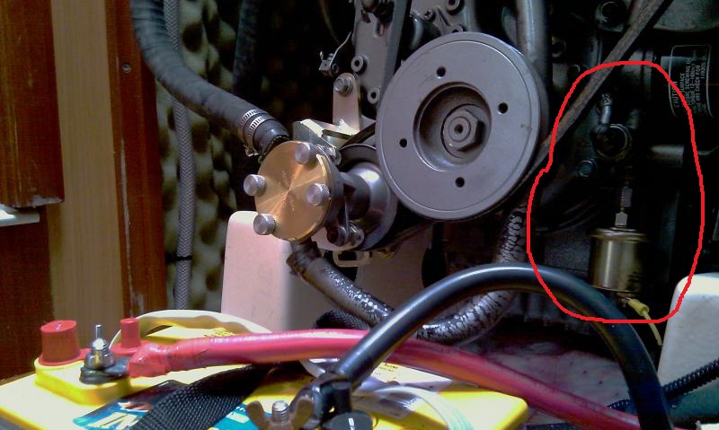

Here is a link to what I have done with my 3YM30. Maybe it might help.
http://forums.hunter.sailboatowners.com/showthread.php?t=114015
http://forums.hunter.sailboatowners.com/attachment.php?attachmentid=27432&d=1258949583
