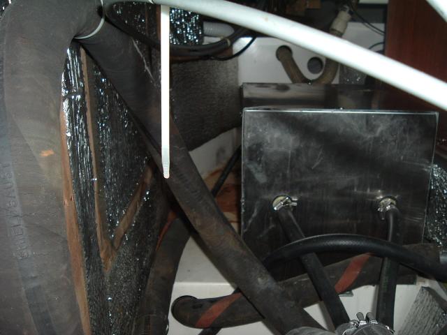

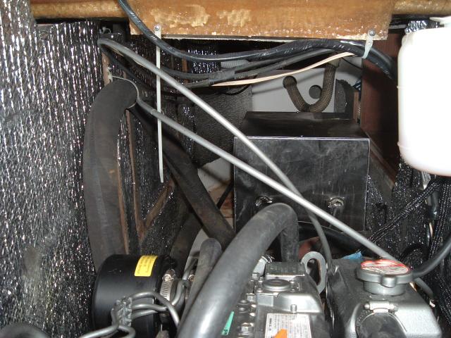

Hi folks, I was able to get in the boat today and start really looking around. The junk is cleared out and I have cleaned- er my wife and I cleaned- er she cleaned things up in the week or so we have had Drifter. We removed just about everything from inside.
The boat is a 37C and it is a 1980. I was told it has a Yanmar 30hp- is this correct? Where does one obtain a comprehensive manual? I couldn't see any engine ID markings.
The first thing I noticed is the cooling water system seems closed. There is a small tank aft of the engine- not quite sure what that is?
I'll stop here for now...

Pics didn't come across.
It has a small tank/exchanger on the starboard side.

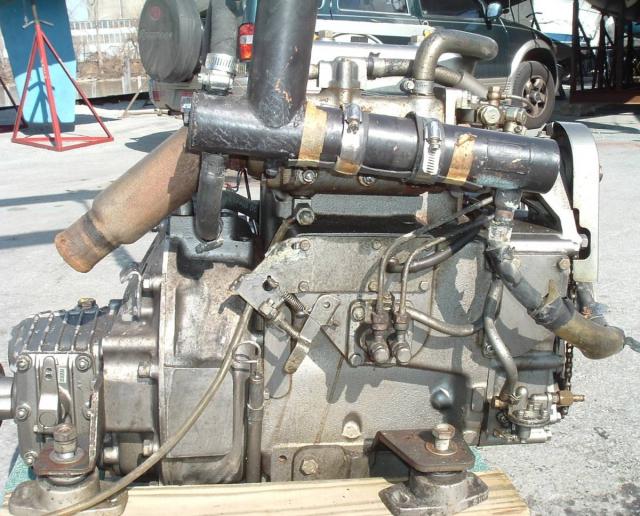

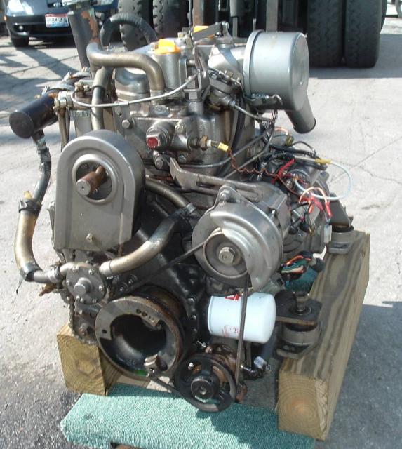

Couldn't find the picture I thought I had. I sold a 3QM30, not a 3QM30F, where 'F' is for fresh water and has a heat exchanger. You know it is a '30' because it will have three injectors. I think the 'F' model had a tank across the front, closest to the companionway. The other distinquishing feature would be two water pumps. An external pump, belt-driven, with a hose from the thru-hull(hopefully through a strainer) and an engine mounted waterpump for internal cooling. My old 2QM20 had an aftermarket heat exchanger, the tube on the side. You can see the two pumps in the frontal picture. External waterpump down right near the oil filter and internal up and left of crank pulley.

Thanks Ed, I almost would say this is exactly it. I will print out these pics and take them to the boat and compare!
What I am after is:
ID everything and locations / change oil in gear and engine / get it running / winterize.
So, there is a tank aft of the engine- small- port side of the gear... what is that for? Not the fuel tank under the berth...?

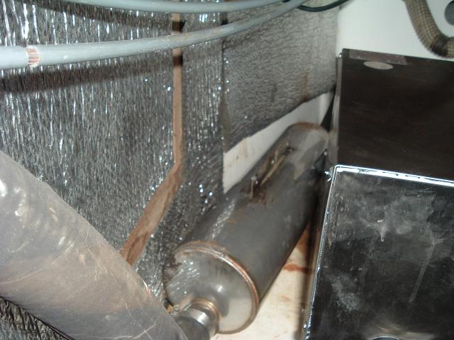

You mean on the shelf behind the engine? On my boat three things are on that shelf. The muffler on the starboard side, hot water tank next to it, and an access plate behind the water tank. That access gets you under the shelf to the nuts that hold the shaft strut to the boat.
In the first two pictures I had the muffler out.

About that hot water tank. You need to open the drain which is at the back. And you need to disconnect the hoses back there and connect them to each other as a bypass. Then you can either blow the lines out or run pink stuff through them.

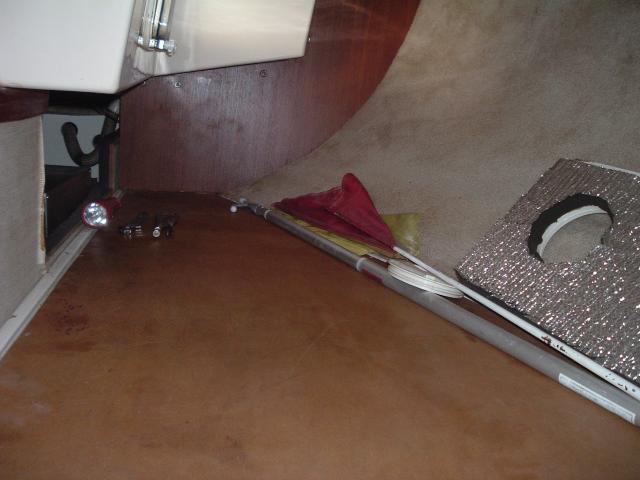

But your boat is pre-1983 which is the year our chart says that a "door" was added. When I first came aboard in 1998 I could not understand how other H37C owners had such good access to checking things like tranny oil, engine oil, and getting to the strut bolts. Turns out they had that "door" and I did not. So I added it.
A couple of feet back on the inside of the quarterberth there is a vertical teak trim strip. Remove that strip and the one at the very back. The top of the q-berth bulkhead is simply wedged under the fiberglass. Now take a saber saw and cut the bottom of the bulkhead from that first vertical trim to the back. That is the "door" that all the later models have for access to the engine, hot water tank, muffler, etc. I know a couple of guys who came even farther forward to start, making the door longer. But under that vertical trim it is already cut top to bottom making it a good place to start.
