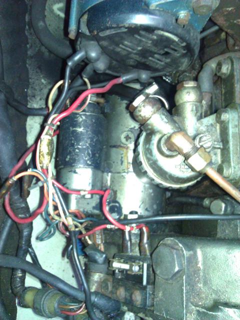

Picture:
Can see the fuse box (the fuse on it 20A it's burned) and the starter engine and the alternator. Before every time i use the starter, would make a spark in the connections of the starter. And last time it came out fumes from the alternator terminals.
On the bottom of the picture can see one (round) plug. They are two and one of them was disconnected before. Also, there is two cables (red and green) on the left side of the picture which i've no idea what they are (no place to connect them apparently)
Missing anything?

Today, as advised by some of you, checked the mixing elbow and the alternator. Both in good conditions!
Today the boat decided to start with electric start but I still have to bridge the fuse in the engine.
The 10A fuse in the start didn’t burn anymore but the 20A in the engine it’s always burning if not bridged.
The engine still run with black fumes when in high speed engaged. If not engaged no problem at all. Maybe have something stuck in the propeller (will check next time sailing).
However, want to solve the fuse burning in the engine before leaving port to check the propeller… In case something serious happen.
So, no battery problem, no alternator problem, no starter problem, no cable problem… What can it be that makes the 20A fuse blow???

The fuse for the starer may be underrate .The starter draw more than 20A while starting.
You have to replace the carbon brush in the starter and the alternator. I check the manual and let you know later.
Boffin
Aug 30, 2010
81
yahama 25 Hong Kong
According to the manual :the starter can take up to 50 A , and you should use fuse at 50A or a bit more say 60A. In the original circuit diagram , there is no fuse on the stater wiring just like many other engine .
For the alternator it can generate 35 A at 5000rpm , you should use 30 or 40A fuse .
Good luck
