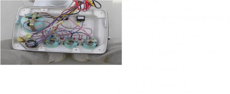

”I am wondering if I have a faulty circuit breaker. Any thoughts out there”
I think you may have – in the engine panel, looking at the innards of this panel (picture saved from one of Tom J’s excellent contributions). It shows, that all positive instrument cables and that of the blower are leading from the breaker. You could well have a loose or corroded connection there, as you mentioned that all these instruments failed together with the blower. That breaker and the blower switch are sitting on the bottom of the panel, where moisture can collect. I actually had to replace my badly corroded switch.
Whilst having the panel open, I also suggest to check the starter button for any signs of corrosion. Mine had no obvious outward signs, but felt a bit sticky. Ignoring this gave me a nasty surprise and the cost of a new starter motor. The button eventually stuck and fried the starter. Replacing the switch was about $5.
