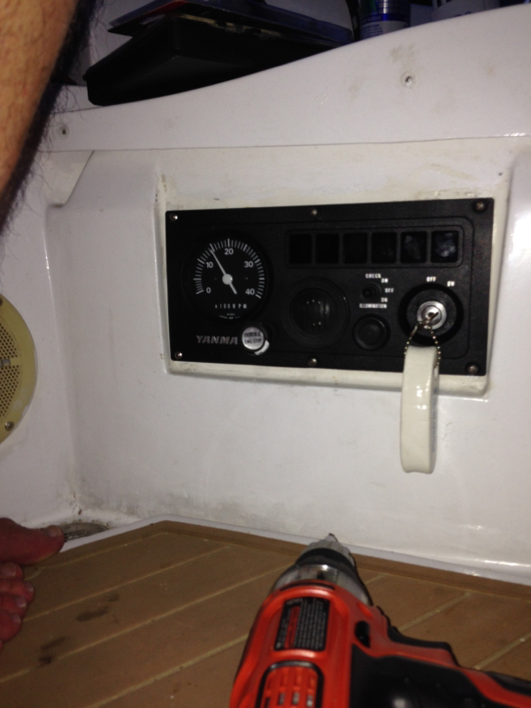

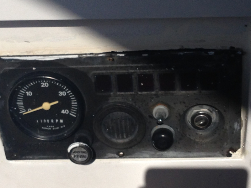

I too replaced mine with a new Yanmar panel. I walked into my local Yanmar dealer and he pulled one off the shelf for $26.00. Their are two types of panels an A and a B mine was a B. I also put in a new tach (that was pricey) but he old one had quit working. It was a simple job, it comes with a gasket to seal it. Sadly, however, my wife did not notice!
Before and after pics attached
