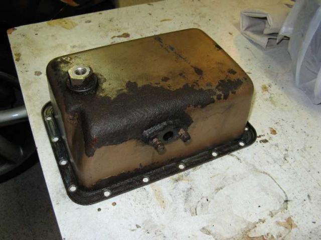

I did this to my engine, though the rust wasn't that bad. I raised the engine about 8 - 9 inches to allow access to the bottom and sides. If the leak has been going on for a while, you will most likely find that the bottom is pretty rusted. The only way to get to it is to raise the engine, especially on a Cat 30. This is what I did: dremel tool with a SS wire brush to get the rust off, acetone, rust converter and paint. You could also use primer before painting (some debate whether or not to do so). If you have some badly pitted areas, you can fill them with JB Weld epoxy and then sand that smooth. Once painted, there's no reason to use BoeShield, the paint will protect the metal. The oil pan metal is pretty thick so it takes a while to rust through but people have lost their engine to just that happening. Here's a picture of a typical rusty pan (way worse than mine):

A new pan would be simpler and better, you could also try to locate the drain at the rear of the pan which would be a big improvement - they may be a little hard to find. To remove and replace, I would use a block-and-tackle and raise the engine to a convenient height for access to all those bolts. It is a big job. Try to get a good look at the bottom of your pan - a hand mirror and flashlight will give you a pretty good idea of how bad it is. The one pictured above could probably go on a long time without rusting through (assuming the salt water leak was stopped). If your's is not real bad, you could use rust converter on everything you can reach to slow it down and replace/fix the pan when it's more convenient. The pan pictured above could be restored to like new condition.
