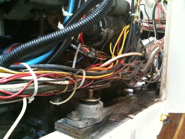

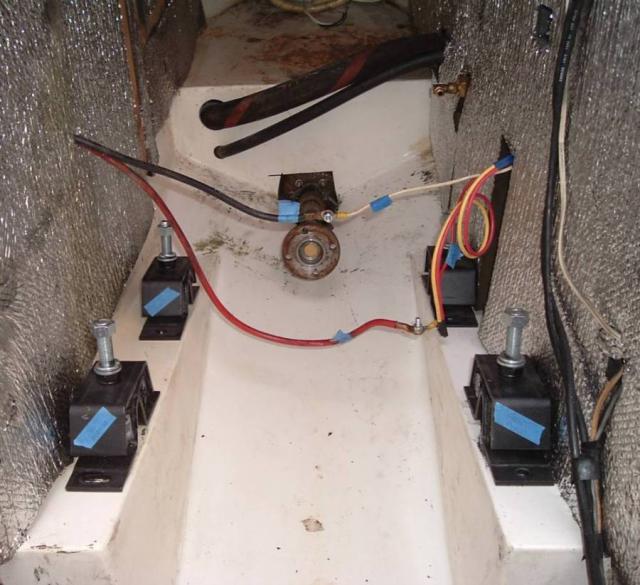

Are you saying that you are loosening the lag bolts that hold the mounts to the stringers? And then trying to slide the engine to port? I wonder if the problem is that the mount holes are like mine and only slotted on one end? See picture.

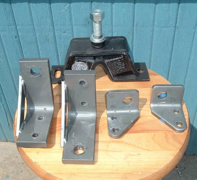

I have the Bushings Inc type mounts. Are yours the standard yanmar mounts because they look much more secure than what I have. This is the mount that I have : http://shop.torresen.com/ships_stor.../8"+Stud,+For+Engines+450-750#&sectionid=5159
I managed to get the engine much closer in alignment with many more hours of trying to find a safe place to pry the engine over with a wood board. I think another hour or two I'll have managed to get it in place.. hopefully.

Donalex's illustration assumes mounting holes being slotted. Yours are and mine are not. My 2QM20 had the mounts that your link shows. Looks like those are slotted both ends. Seems like you are almost there.

The picture in the link that "inquiztr" included in his second posting showed slotted holes. How else does one align the engine- or are there large holes in the engine's brackets and large washers.

Thinking more about this issue I can see that my mounts, with one end having only a round hole, would still allow a certain amount of lateral adjustment.

Its seems that you are right, one of the mounts has reached the edge of the slotted clearance however I am almost there with the alignment.
The previous owner has a mish mash of two different engine mount types being used. One is the bushings inc brand mount I had linked to which I like and the other looks similar but doesnt have the cast iron casing around it so the rubber busing is exposed, and the base is just a steel plate. This brand doesnt have as large as a slot to move the mount over so I will replace it this weekend and I think that will solve my problem.
I dont have a clear picture of the other kind but you can see the one closer is the better kind.
