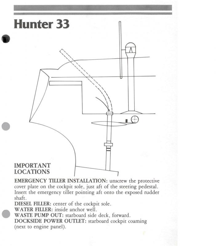

The actual emergency tiller should be stored in one of the lockers if you have one. I don't know what yours would look like but it should be an "L" shaped piece of metal with a coupler on one end and long enough on the other to give you some leaverage. Where does that tiller attach to? Usually to a slot on top of the rudder shaft which should be in the boat's centerline behind the wheel steering assembly. Check inside that locker which doubles as a helm seat.

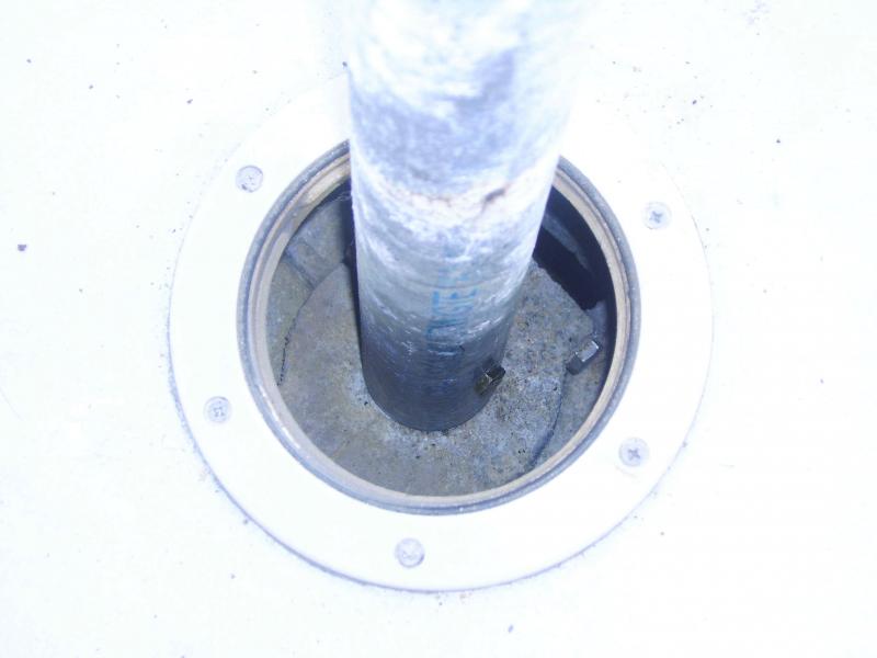

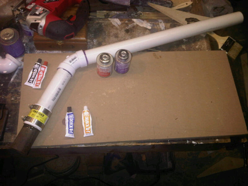

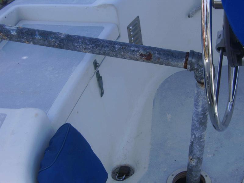

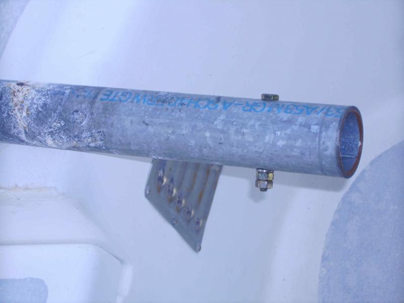

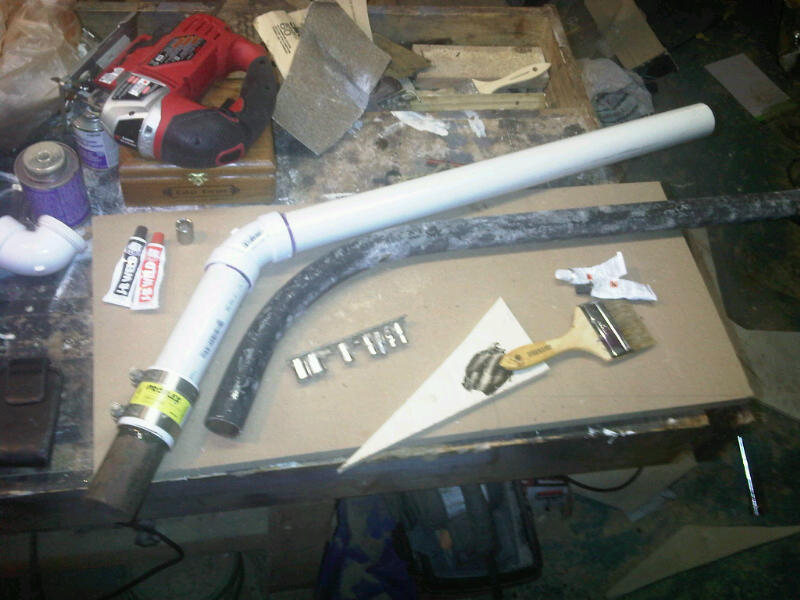

If it was like mine, it might be the pile of rust you might find behind the water heater. I need to put another handle on mine. The bent galvanized pipe (as shown in rardi's picture below) is completely rotted. The head (business end of the e-tiller) is still serviceable.
Update: I stopped at home depot on the way home tonight and picked up a few parts for the e-tiller, and just finished putting the e-tiller back together. The head of the old e-tiller slid in perfectly to a union. I reinforced this joint with a SS-coupler covering the union. I used JB Weld for the steel to PVC joint. The rest of the joints were standard PVC adhesive. I will reinforce these joints with ss-band/hose clamps. The angle of the handle is about 10 degrees higher than the old one, but it will work. I will test it out this week to see how she feels under power.

...just finished putting the e-tiller back together. The head of the old e-tiller slid in perfectly to a union. I reinforced this joint with a SS-coupler covering the union. I used JB Weld for the steel to PVC joint. The rest of the joints were standard PVC adhesive. I will reinforce these joints with ss-band/hose clamps.
Rich, please tell me you didn't just make an emergency tiller out of PVC pipe! :eek:
:redface: As a temporary, yes. The one in the boat was falling apart (rusted out galvanized thin wall pipe) and I needed something quick until I had a suitable replacement. I have tested it out and it works fine in the boat. The PVC is fine as a casing but it is not very strong structurally. Add a structural core and it will be OK.
