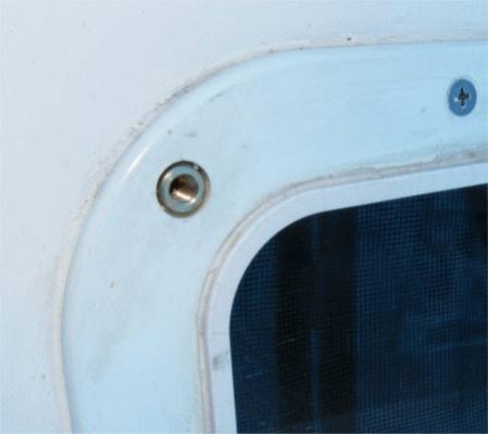

I'm going to bump this up out of a thread directed at Beckson port owners because there are other plastic ports out there and this project has turned out so well.
Even if you don't carry a full set of storm covers, you might want a means to put a plywood or plastic emergency closure on a broken port without having to have a strongback on the inside. This was quick and easy.
http://www.rogerlongboats.com/09Winter.htm#Sockets
Check the same link in a week or two to see the storm covers.

What is your game plan for the covers?
Plan A was to cut up the stock of Acrylic I salvaged from the Linen & Things liquidation into spacer rings and covers. That plan died when I found out what a bitch it is to work with the stuff with the tools I have on hand.
Plan B is to buy a set of trim rings from Beckson to use as the spacers and make covers out of the Acrylic. I might use Lexan for the larger ports. Unfortunately, this requires cutting down the spigots which stick out beyond the 3/16" thickness of the trim rings. It's not a job I really want to take on.
Plan C: I'm going Wednesday to talk to a company that does plastic fabrication for the marine industry to see if they can make 5/16" spacer rings of a soft plastic and Lexan covers for a price I can afford.
Stay tuned.
Definitely Plan C!
I can get trim rings AND lexan covers CNC cut to my exact specifications for less than the cost of buying a set of trim rings from Beckson. They will arrive all ready for me to just drill the holes for the bolts.
