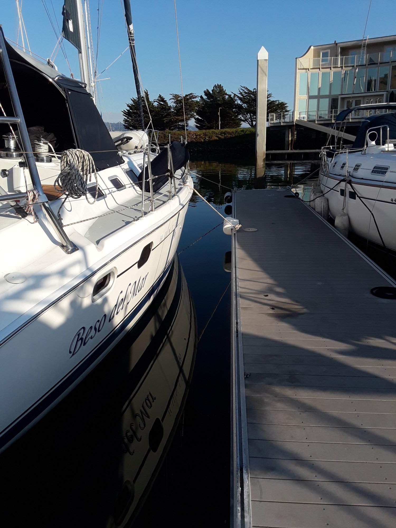

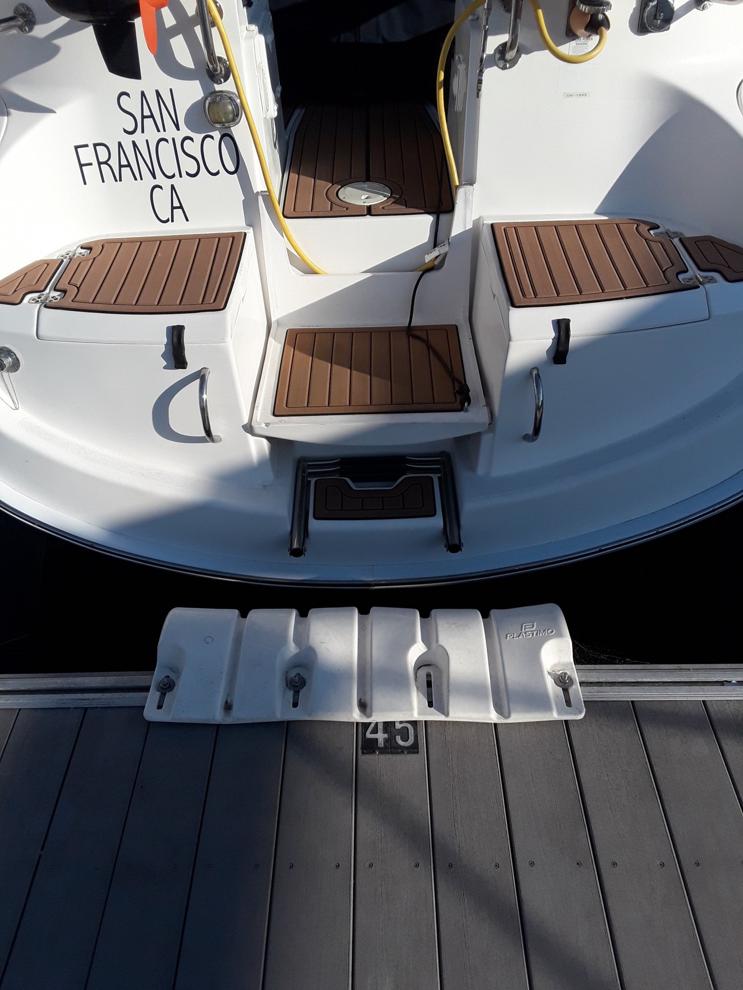

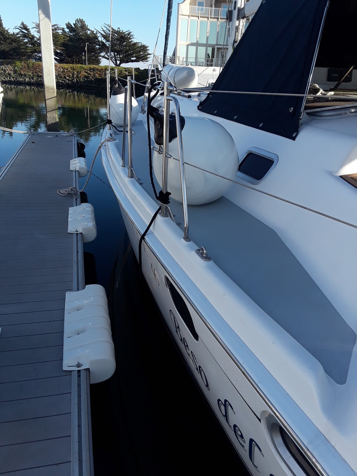

Attached are photos of my berth fender installation. I secured one Plastimo fender on the upwind starboard side finger with one soft 10" x 26" Taylor-made fender at the berth entrance and 3 on the downwind port side finger with one 10" x 26" Taylor-made fender at the berth entrance. I no longer need to exit and enter my two finger slip with fenders secured to the boat.
Plastimo just improved their fender dock mounting hardware by making them longer with tapered edges to "lock in place" and changed the nuts to nylon nuts to keep the nuts from unscrewing. The first hardware set I purchased early this year worked its way loose and I lost one bolt to the water.
I also stow fenders in the aft lazarette for docking at other marina berths.

The ones I’ve seen around here are solid foam and not as flexible as inflatables. And if you dock elsewhere, ....

Funny the timing, I just saw these and asked the marina if they minded me installing them in my berth. I had the same concern as Don with respect to the hardness of them but it is worth a try as I hate having fenders laying on the deck.
I plan to keep the regular fenders in a locker for use if I go somewhere.
I think I am going to hang one fender from the dock right at the point of the widest beam as well.

"The wind never changes direction ?"
The majority of the dock fenders (4 out of 6) are currently on the downwind side where the wind is from the west for 9.3 months, from February 9 to November 17. The remaining time of the year I can relocate the fenders, if necessary, to the other side where the wind is mostly from the north for 2.7 months.
But oddly today (October 27th) the wind is unseasonably out of the north north east at 25 knots gusting to 65 knots.
By the way the Plastimo dock fenders are relatively soft.

;) Hence the reason for my question. IMHO, invest in a few extra fenders and don't count of predictions (or fortune tellers). Prevailing winds are not a rule. Storms and unusul weather patterns happen, and you can't always be there in advance to move fenders or lines.
If I leave my boat for more than a day, I secure it as if I'm leaving for a month. Things come up and I might not be able to get back to it as planned.

Totally agree with your point!! When I leave the boat I keep it floated in the middle of the berth with additional fenders on both sides. However, when exiting and entering my home berth I no longer need to put fenders down with this new dock fender arrangement when the wind is out of the west.

The problem with fenders on the dock is that as the boat rocks up and down the fenders rub on the boat and eventually wear on the gel coat. On the other hand, fenders on the boat rub up and down on the dock and are gentler on the gel coat.

Agree with your point. That is why I have fenders off each side of the boat while berthed. The dock fenders are only for existing and entering the berth.

Then why not simply put the inflatable fenders over the side before entering? I don’t get the benefit.

I'm with Tally Ho … it looks great! Nice job. It takes the stress out of docking and eliminates the need to secure fenders on board. If my boat were rubbing on fenders while docked, it would mean that I did a lousy job securing my dock lines.

Because hung fenders can be pushed out of position. Also one less thing to do. Don't knock it until you have tried it. It's easy. Every ferry dock is padded.
I have always lashed a few position, with every boat I have owned. Also handy for loading and unloading (pull the boat over tight). the fenders never bear while away from the boat--no rubbing.
