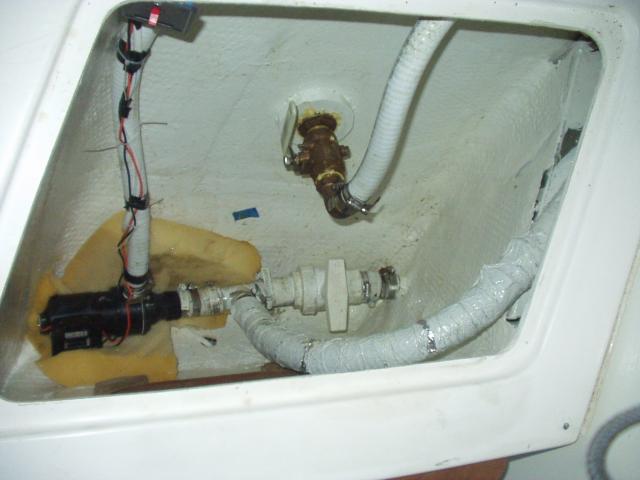

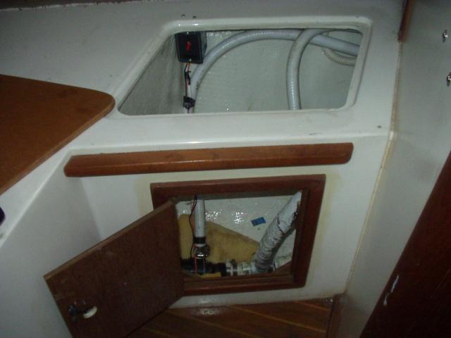

I still have the original aluminum holidng tank. The location is great since next to the head ( under the shower seat) with 2-3 ft hose run from head to tank. But the orignal set up out of the tank, was a hose run under the sole to the other side of the boat, then three hoses mounted in the hanging locker ( vented loop and deck discharge) with the thru hull discharge across the boat from the tank and head.
Last year I moved the deck discharge so on same side of boat as the head and tank. This year I abandoned the old port side thru hull, and pulled the vented loop out of the hanging locker. Pulled ou thte old manual Whale gusher pump and installed new thru hull, starboard side, macerator, shut off valve at the tank discharge, and ran the vented loop and deck discharge up behind the shower. So ALL the hose is starboard and contained in one locker.
I do need to anchor the marcerator motor and get some closed cell foam.
Should be a couple of pics attached ( hey it worked :dance:)

Peggie, closed foam because I don't want a chance of "anything" getting absorbed. Or what else should I use to dampen noise/vibration from the pump?
Ed, I was on a '79 and it had the same set up with all the hoses running to port side deck and thru hull discharge. I guess that was the only place to easely run the hoses up ( in the hanging locker). It was a real bear working hoses up behind the shower, though there was already an access plate in the shower above the faucet.

I wouldn't dampen the macerator pump noise
It's not as if the macerator is toilet that can jar everyone out of a sound sleep if it's flushed at night...the only time it'll be running is for the 2-3 minutes it takes to dump the tank...the noise will alert you to turn it off before the impeller fries if you get distracted while it is running.

Peggie, as usual, you are correct. Damn.
