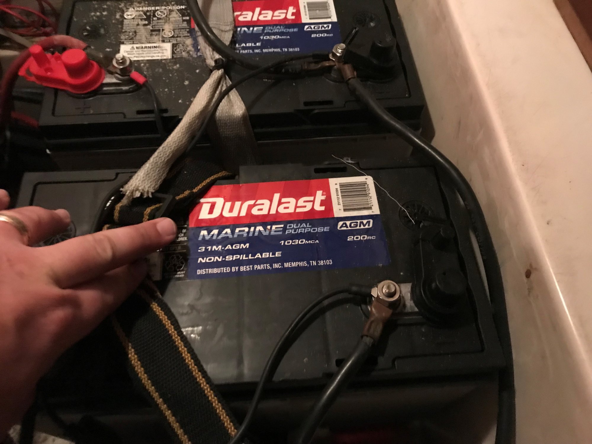

I have two, new-looking, group 31, AGM, "Marine Dual Purpose" batteries run in parallel. There's nothing at all fancy about the setup. Only one bank and no house/engine separator.

Unlike people, even dead batteries can look good. How old are the batteries? How have they been charged, what charger are you using? AGMs are especially sensitive to be left in less than a full charge. If these are West Marine/East Penn AGMs, they are not the most robust AGMs out there.
Check all the connections including DC- connections. Poor connections can cause voltage drops which is the likely cause of your symptoms.

When was the last time you checked all the wiring and particularly the integrity of all power connections?
I haven't really checked connections well... Just a visual. Alternator reads good though. I should probably disconnect everything, give it a scrub, and put on some kind of corrosion inhibitor. One thing I just put together is that the batteries are in paralell, but there's a 2 bank tender- one on each battery. Wonder if that's bad. The tender may be this Deltran 1.25A model (or older version).

In battery health there are 2 factors to consider, State of Charge (SOC) and Capacity (Balmar calls this health). Resting voltage, i.e, no load and no charge for 24 hours will estimate SOC. However, the more important factor is capacity. Over time batteries decay through use. With each charge/discharge cycle a little capacity is lost. After a few years a 100 ah Group 31 battery will no longer have 100ah capacity, it will be much lower. For AGMs cycles are important as well as the charging protocol and time spent in a partial state of charge (PSOC). Either of these, especially long periods in a PSOC state are deadly for the AGM batteries. Repeatedly drawing the SOC down below 50% of capacity is also deadly.
If the electrical connections are tight and clean, the issue is probably the batteries. There may be a date label on the batteries, it would be good to know how old they really are.
AGM batteries may not be the best choice for you. You have to look at how you will use the battery, how it will be charged, and what you can afford. You are correct, the price of AGMs is quite high. Also, if you parallel the batteries, they need to be equally charged, of the same chemistry, of the same age. If there is an imbalance in the batteries, i.e., one old, one new, the bank will sink to the state of the weaker battery.
