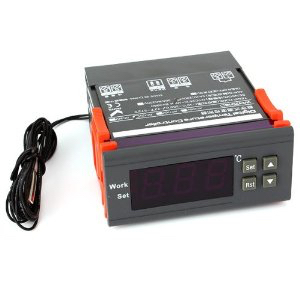

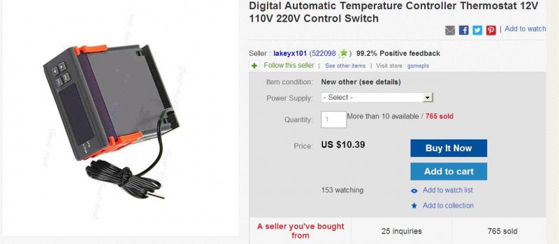

I know a number of you have replaced your mechanical thermostat with an electronic one from China. I bought one through Amazon to do the same. It does not indicate the polarity of the inout power on pins 3 and 4, either on the case or instruction sheet. If anyone has used one like the one in the picture I would appreciate any information you could provide.

Given there are no polarity markings on pins 3 and 4, I would assume these are the ON/OFF contacts (no polarity) to your compressor relay. Just to be sure, connect 12V to your other contacts (+ and -) amd then check for conductivity on pins 3 and 4 as you raise and lower the set point. Should make and break.
But far more important (to me anyway), is that the stat looks fairly bulky. How will you be installing it in the cooling compartment ? I'm looking at a failing stat as well and will be replacing with an electronic unit.

I am going to use it to turn the spill over fan on and off. The mechanical thermostat turns off at 40* and on at 34* too much hysteresis. I will mount this one outside the fridge under overhead galley cabinets, the temp probe obviously will be in the refrigerator compartment.
It is designed to run on 12 volts. It has two terminals for power in, neither has any polarity markings. The sheet indicates they are for power in but does indicate polarity either.
These are marketed under a variety of names but are either made in the same factory or they are cloning each other.
Bob

Bob ................. maybe that's a bit excessive for the hysteresis (dead band) of the mechanical stat. Have you looked at the dead band for your electronic unit or is it adjustable (way too much to hope for) ?

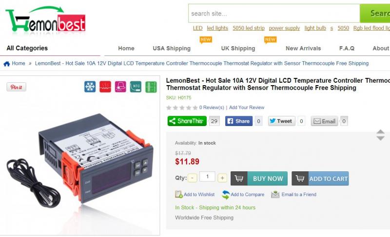

Don't know if this is the one you purchased but as you've said, there is an endless supply of these things on the market under different names and all looking identical. The one I found goes by the name Lemonbest and that is one scary:eek:, scary:eek:, name.
Given that this is not part of a critical boat system and can be easily controlled by hand for a few days if the need arises (OFF/ON breaker) I've ordered one just to give it a try. If it fails ......... no great loss but definitely worth a try.

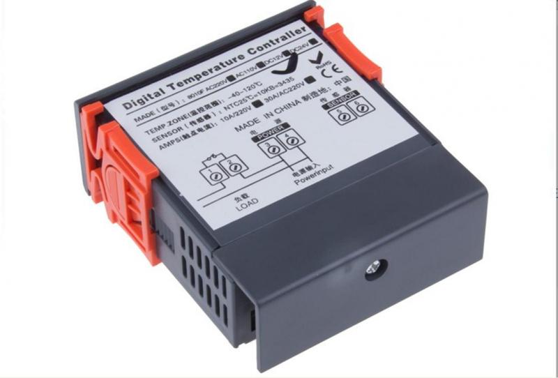

Ralph, yes the electronic thermostat has adjustable hysteresis and was one of the reasons I ordered it. The picture of yours looks identical to mine, note the power input terminals, 3 & 4, do not indicate the polarity ! Almost cheap enough to just try it and see :). I just don't have the time to wait for another one. Delivery on the last one was 3 weeks. You might want to order two !
I hoped to get this installed so it would be easy to set the temperature on the fridge, maybe save some AHrs and not worry about freezing the salad. Right now it seems it always needs a little touch, either too cold or too warm.

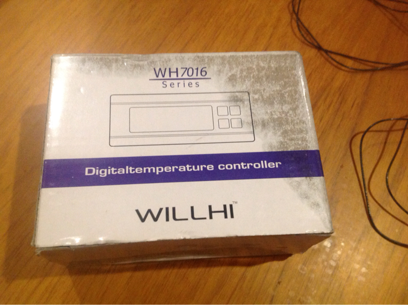

Ajustable dead band ............ my prayers have been answered.

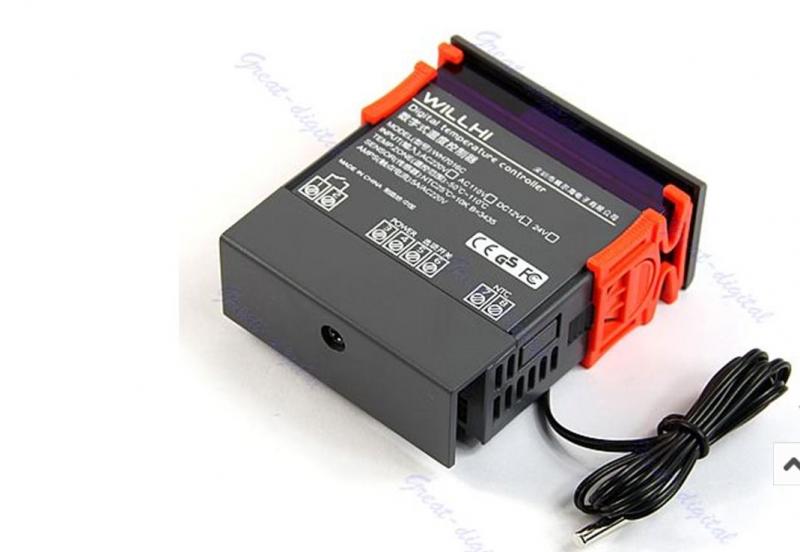

Can you please give me the brand name of the unit you have pictured ? Too small to read.
I may wind up with the other one I've ordered having adjustable dead band as well. But at that price, big deal:dance:. Delivery time from China is several weeks which I'm sure will grow into a month or better.

Yipes ........................
.............. that's over double what I paid for this one and no shipping charge.
There are more of these things out there which "look" identical to each other than you can shake a stick at.
I don't really expect a lot to come from ordering one of these stats but at these prices, you can't go too far wrong even if it doesn't work at all. You can be sure I'll be watching this thing like a hawk for the first little while. At least I'll have a temp. readout to monitor the stat rather than the previous one which made beersicles and froze the lettuce.

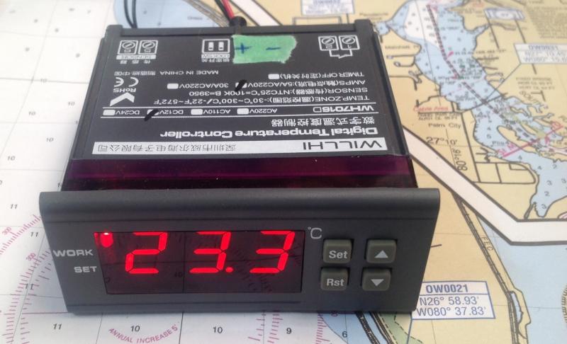

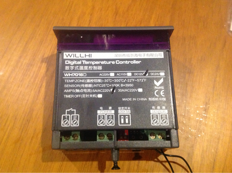

Rich you did it !
Thanks again, it works !
Next job wire it into the refrigerator. That may have to wait until we get to the Bahamas. Too much to do right now to start another project.
Bob

No thanks needed. Google (and persistence) is your friend.
