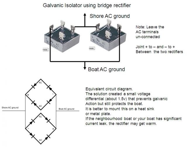

Alex,
I had no idea that galvanic isolators were that simple - Its almost a crime the prices they charge for those things.
They are not that simple if you want to meet the current ABYC standards as they must fail safe or have idiot lights..
