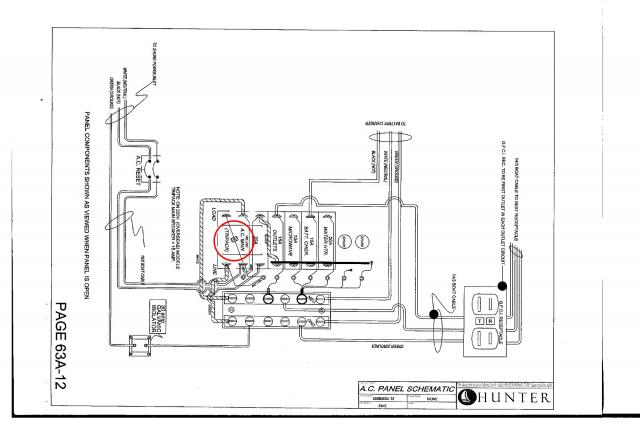

I see there is a little device, kind of looks like a diode wired in the a A/C circuit called a "TRIPACK" does anyone know what that does?

Why did you focus on that part, does it look burnt / smell / anything? Can you attach the schematic you are looking at ( via scanning or picture ) . How about a picture of this tripack.

I have attached the schematic I am using
The Tripack is circled in red
It is a very small solid state part, maybe the size of a small diode

John, I could not make out too much on your attached file so I found and downloaded the 356 manual ( very nice manual, btw).
From what it looks like to the that TRIPACK is probably a diode that will turn on the Reversed Polarity light. With shorepower disconnected and main CB open, you can check the diode with the ohm meter. One probe on each side of the device. One way should read 0, swap the leads the other way should be open. Any numbers on the device (diode)?
The manual says to check CB#1, It should be in the Port cockpit locker. Look at page 63-A2, 63-A10 for the location. Since the main power light is barely on, I would suspect the problem before the main panel, around this CB1.

Actually, the Airpax Tripack is part of the circuit breaker assembly. Google it and you will get many results on the part, need to match up the part numbers for the exact function.

I am experiencing a similar problem. I don't know the answer, but I will tell you the little "diode looking part" is not the problem. It is called TRIPACK on the drawing, but it does not refer to that "diode looking part" but rather it referrs to the set of three switches in a single assembly block called TRIPACK. The diode looking part is a surge protector, which is likely not the culpret. Wish I could help further. I'm trying to find and purchase a TRIPACK, but no success yet. Feel free to e-mail bill@rmcfam.org
