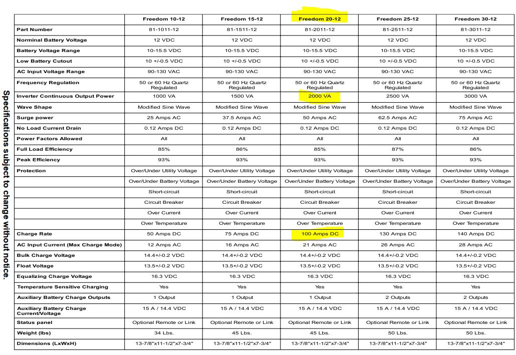

I was trying to look for information on dakno's charger, as many Hunters of that size came with an I/C, and I stumbled across a post from Dec 23 of 2018..
From Dec 23, 2018
Is getting close to the time for new house batteries. I am currently on the second set of 3 4D AGM 192ah each batteries. This is what came with the boat as new from Hunter.
Thanks
Feb 6, 1998
11,711
@Maine Sail have the same Hunter if all is the same it would be a Xantrex Freedom 20 stated output for the charger is 100 amps max
That is typically what we are used to seeing on those boats and it is an inverter / charger 2000W invert and 100A charge... That said, lots can change from owner to owner and while some of these old Freedom's seem to last forever some are dead in two years, especially after Xantrex took over so it may be possible dakno actually does have a 20A charger?

Thanks all, enlightening, Daydreamer and Mainesail. I do have the original from Hunter xantrax freedom 20 which book states that it has a 20amp charger and 2000w inverter. Is it 20 amps or 100 amps as stated by others? Best I can tell these boats came with one 4d agm... the other 2 were either options or additions but all three are professionally installed. Artboas..what 6v AGM's did you choose? Also I have a email sent to Marine How to about charger and house batts.?? Thanks, I am feeling better for a minute
Your inverter charger has a 100A charger. Your batteries are not made by West Marine they are made by East Penn and West Marine slaps a sticker on them and then charges an insane mark up beyond numerous competitors selling the identical battery with a less expensive sticker.. The batteries, if they are indeed 4D AGM's, are the same exact battery as the Deka 8A4D.

I have the Freedom 20 and its output is 100 DC Amps and I have verified that.
