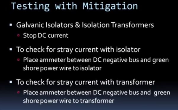

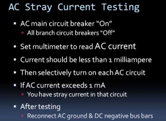

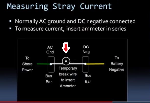

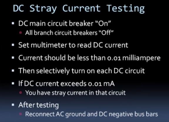

Here's some added info to find stray current too! I installed a switch with an AM meter between AC and DC grounds. Remember, it's important to isolate where your problem current is coming from AC or DC. Hope this helps!
Capt. Rob
Likes: RoyS
