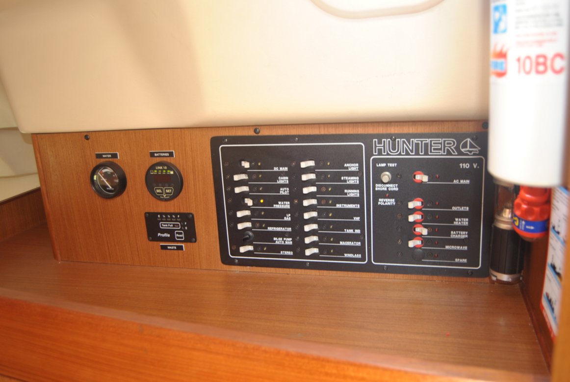

anyone have a source for these 'on' LEDs? Years ago the only ones I found were too big. The hole seems to be about 1/4". The LED is noticeably smaller. Thanks!

I've got a few here purchased from the SBO store to fit a Hunter electrical panel. If this is your panel, they fit.

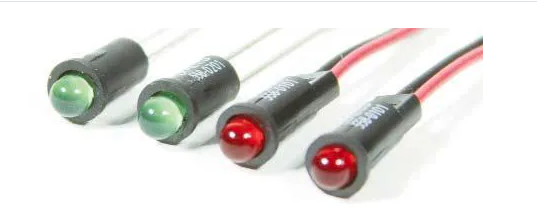

I did a google for indicator LED panel lights and got about a gajillion hits. You should be able to find something you like and fits well but it may take a minute.
The pic came from here.

A few years ago, I ordered Blue Seas LED lights for my panel. Had to slightly enlarge the hole with an 11/64” drill. Fit perfectly. Ordered the light & drill from Amazon.

Unfortunately “these guys” maybe the same Blue Seas LED panel lights that @BigEasy installed. He had to enlarge the hole to 11/64” and the Hunter store LED shows a mounting hole size: 11/64".
