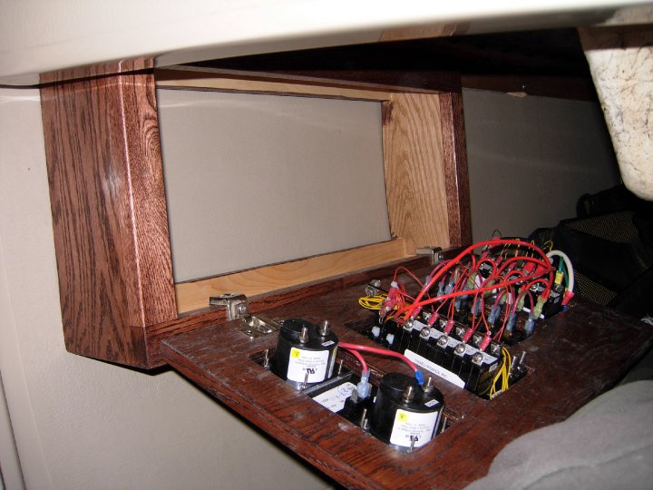

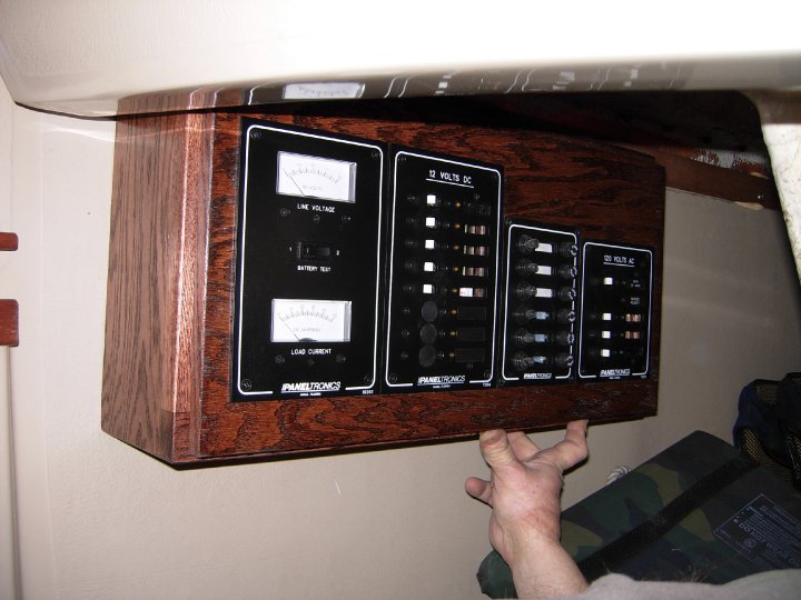

Like you, I got tired of the panel on the floor getting wet. I built a new panel and mounted it near my AC plug in the forward part of the pilot berth.(traditional layout). I drilled a hole in the liner forward of the 'box' and remounted my batteries under the pilot berth with fuses on the bulkhead under the settee. The battery switch is mounted on the forward face of the panel box.
