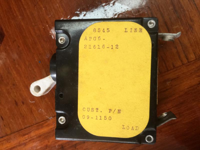

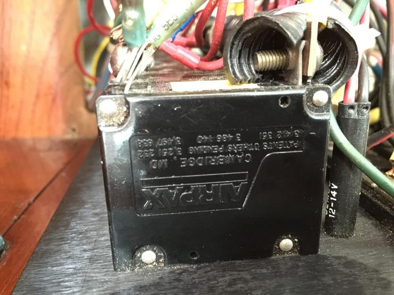

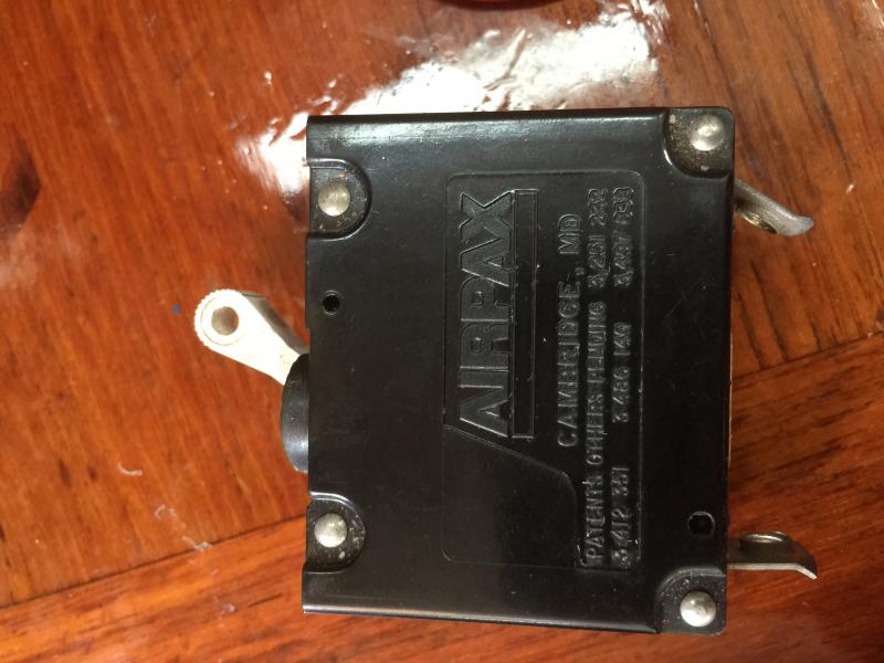

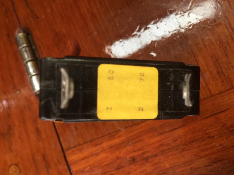

I don't mind buying and installing a new main breaker but I can't find a supplier for the AirPax used on my Hunter H34. Does anyone know if another brand will fit?
23,093
Sure, it's just a standard breaker.

Thanks for the advice. I'll pick up a new breaker today. Any idea what the original AMP size would be. I haven't really added load much since new.

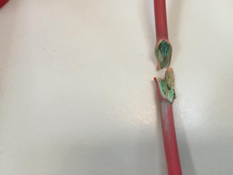

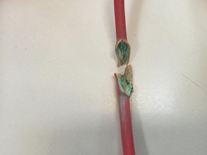

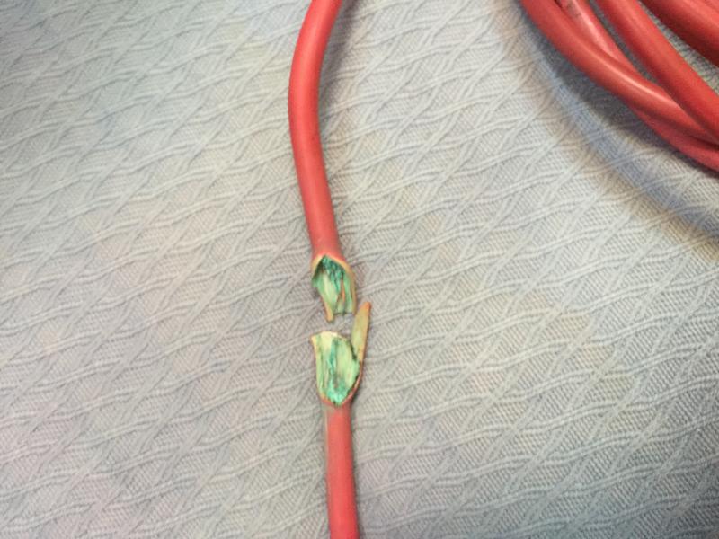

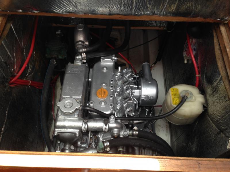

It was the main power wire running from the battery switch to the circuit breaker panel. It runs from the battery switch through the engine compartment underneath the floor and back up to the panel underneath the navigation table. on my boat it runs alongside the main ground which follows the same path and terminates on the engine block. It also runs alongside brown cable for the auxiliary power use for the bilge pump and a Romax style marine cable for the AC power on the starboard side of the boat. These four wires run underneath the center of the boat inside of a flexible conduit. Apparently One of the previous owners ran a new power cable but did not use tinned marine grade wire. As a result I've spent several hours trying to troubleshoot this issue. Thank you to everybody for their advice. Hopefully somebody can avoid this in the future by reading this post.

"AIRPAX™ brand products are now produced under Sensata Technologies, Power Protection Division. Sensata Technologies has acquired Airpax Corporation"
Even though you have solved your problem, for future reference you should be able to find a part number on the breakers and at least the current rating of each breaker. I re furbished my electrical panel and was able to get exact replacements for all the AC breakers and a couple of the DC breakers.

Thanks for the reference. I just used a blue sea brand from West Marine for convenience. Also if you're interested, awhile back I also posted where you could buy the indicator lights.

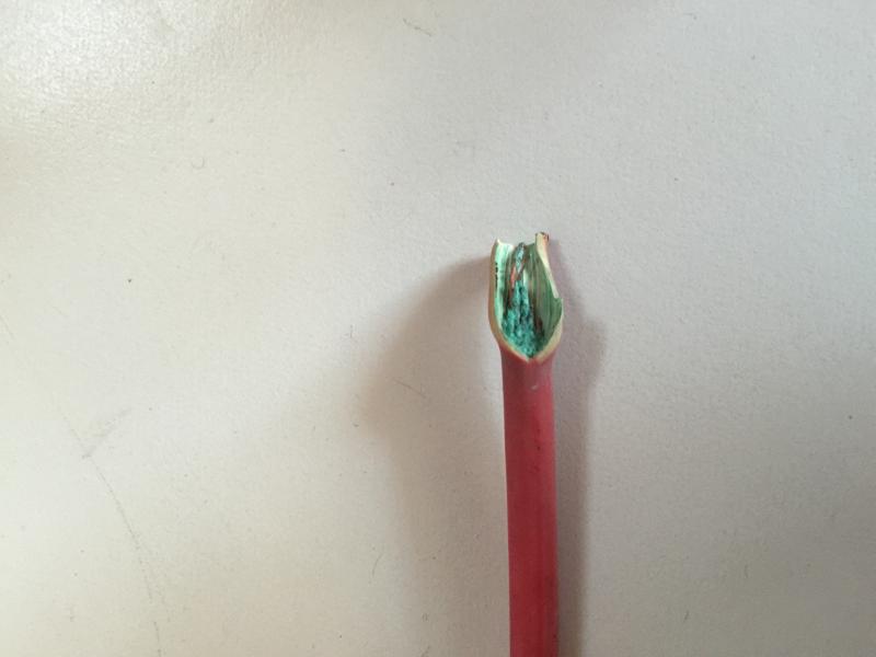

I replaced the old 12 AWG copper wire with 15 feet of red 8 AWG tinned marine grade wire. The previous owner neglected to use the proper wiring when he installed new wiring a few years ago. The problem was fixed but it was a lot of trouble figuring out what needed to be replaced. As I said initially, I was getting voltage to the main breaker on the panel but it was not consistent nor was it the same voltage I seen on the batteries. I went to the store and bought an inexpensive continuity tester and I was not getting a signal through the main power line. This tool proved to be better at diagnosing the problem. I then confirmed my suspicion by running a temporary power line.
It was very tempting to jump to conclusions and think that I had a short or some other part had broken. Once again the lesson is start with the basics and eliminate the easy stuff first.
Attached are pictures of the main power line that was removed.
Fishing the new line under the floor was not easy. I ended up tying a string to one of the good lines and pulling it through since the power line was broken. I then tied the good line and the new power line to the string and pulled everything back though.
