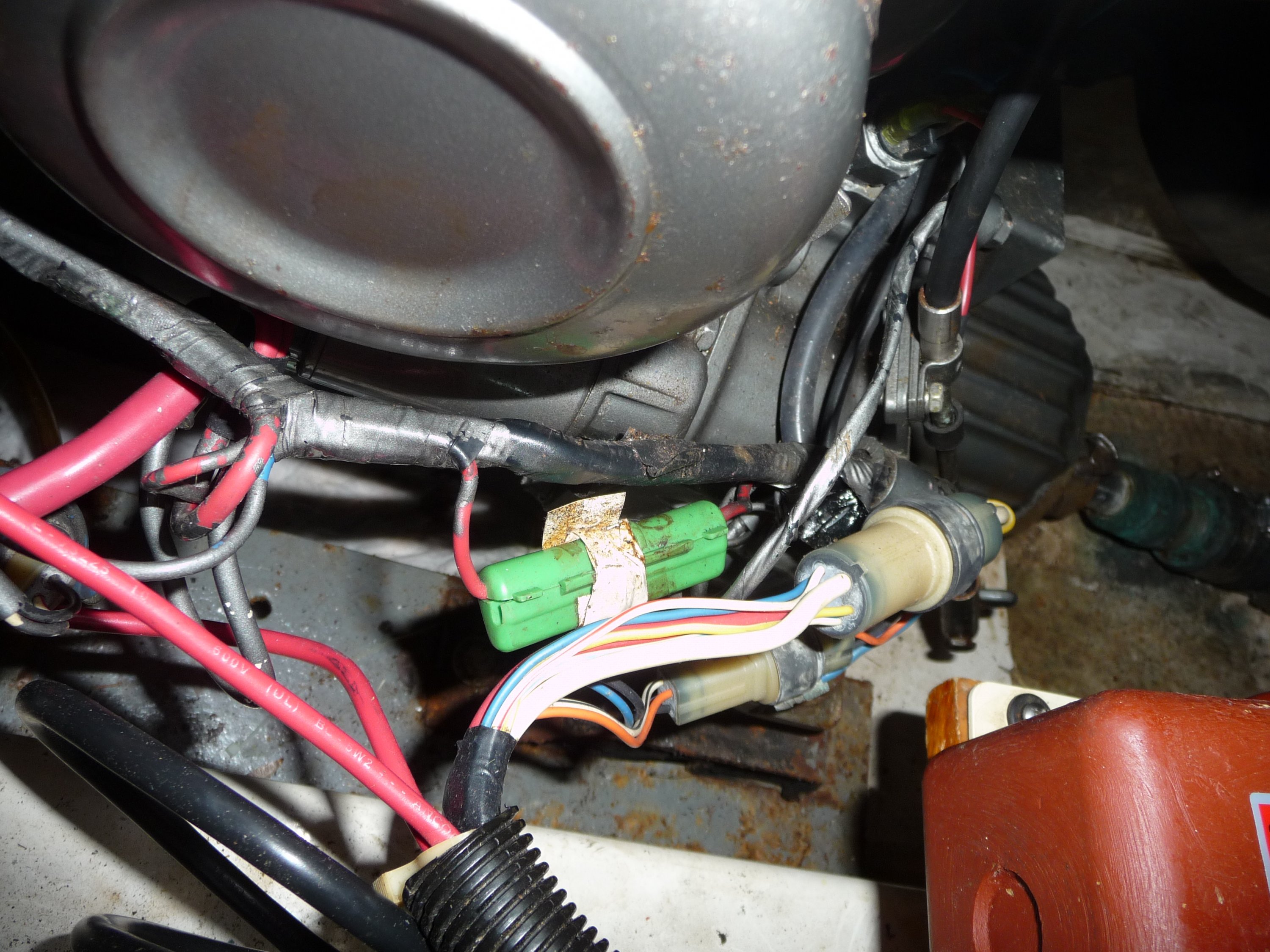

Not familiar with the wiring on that Yanmar, but on others, there is a 10 amp fuse in a little box on the main power wire that feeds the panel.. That fuse box is ...uuuuuhhhh.. substandard.. and sometimes bumping it will cause it to lose connection.. you are correct in observation.. when you turn the switch on, the panel should power up and the oil pressure alarm should sound. The little green box with tape is the fusebox on the 3GMF engines.. The multi wire connectors (2) should be cleaned .. and check the ground circuit for good connections as well.. You can clean the connectors with a small piece of sandpaper rolled into a tube.. insert into the female plug and clean the sockets. 200 grit is fine enough.. clean the male prongs too..

Ford service books used to have a "wiggle test" suggestion .. turn the key on and carefully wiggle the connectors one by one until you hear the low oil alarm.. that one needs attention..

I like Kloudie's wiggle test suggestion. If you do the test, be sure to spin the wires that go into the little green fuse box to insure they are passing enough current to sound the low oil pressure alarm or simple take the fuse out and clean and check it. On my 2gmf the fuse box is white and poorly made. The tape keeps it from popping open.

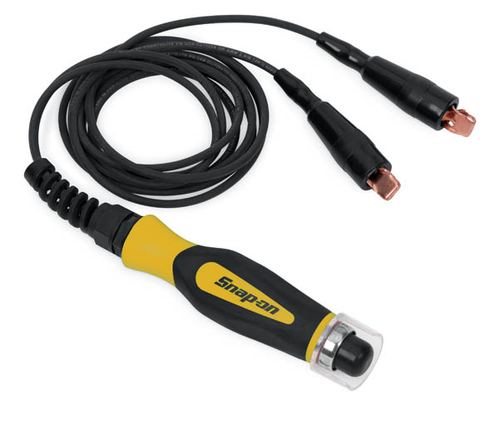

is there a way for me to jump the engine without the panel just to see to make sure the engine running fine with the new tank and fuel filters?
A remote start switch is a very handy tool for working on engines, doing valve adjustments etc. and saves a trip to the cockpit.. You can even permanently install one, in the engine bay, as an emergency back up.
