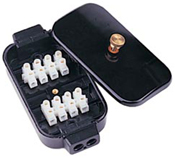

what do you think of a waterproof connection box?
or do you prefer a wire thru hull?
I’m leaning towards a waterproof box

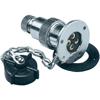

I assume you are talking about the electric wire that goes to the anchor/steaming light on the mast. If that is correct, I use one of these
If that is what you are looking for, do a search for 12v marine watertight deck connection

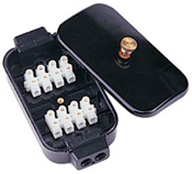

yes that is what I was thinking of, but I also saw this model054_AAA10094.jpg
not sure if that is any good
12,756
Yeah I’m not familiar with those
Not sure how you get the wires through the deck with that

I have 3 water tight deck connections at the mast base (lights, wind vane, VHF). There is an access panel beneath the deck stepped mast and the cables are connected in one of the “water tight” junction boxes there. The VHF actually has its own through deck connecter. A drip loop in each of the wires above deck along with the through deck connecters keeps any water from running into the access area. I only take the mast down every couple of years, not as if I am a trailer sailer or have to take the mast down for winter storage. If I was a trailer sailer, I would definitely be looking for a more expedient way of disconnecting and reconnecting.

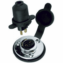

View attachment 174124View attachment 174125View attachment 174126
See this thread too: Deck to mast electrical connection I haven't. tried the first connector pictured above, but I had bad luck with the. second one. I'm happy with a Scanstrut through-deck and a trailer connector. Pictures in the linked thread.

My C&C27 with deck stepped mast has 2 of the chrome plated glands shown on the right in post #2. One for the VHF antenna and one for the mast lights. The wire comes through the deck gland then to a connector - N-type for the VHF then a 4 pin water resistant plug for the mast lights. It ends up looking sort of like post #13 in the other thread but with a chrome plated feed through gland Deck to mast electrical connection

I have the first connector in use for my solar panel which I take into the cabin while sailing and it sitting in the cockpit charging the battery while at dock. I also used one for my autopilot. After 5 years of plugging-unplugging the autopilot connection began to fail. I spread the prongs to get a better connection until the smaller one just broke off. Don't use the autopilot on my Capri 22 as it balances so well that I can leave the tiller for a couple of minutes without any significant course variation (as long as the wind is steady and not varying in amplitude or direction significantly). May add the autopilot this year so I can eat lunch while I sail without worry. Or use the facilities other than over the side. My last TP-10 would not calibrate on my Hunter 23.5. I burned out a TP-10 every two years on the Hunter because of excessive weather helm I just couldn't get rid of no matter how focused on sail trim. Water ballast just not a good choice for good sailing characteristics. Good for launch though.
