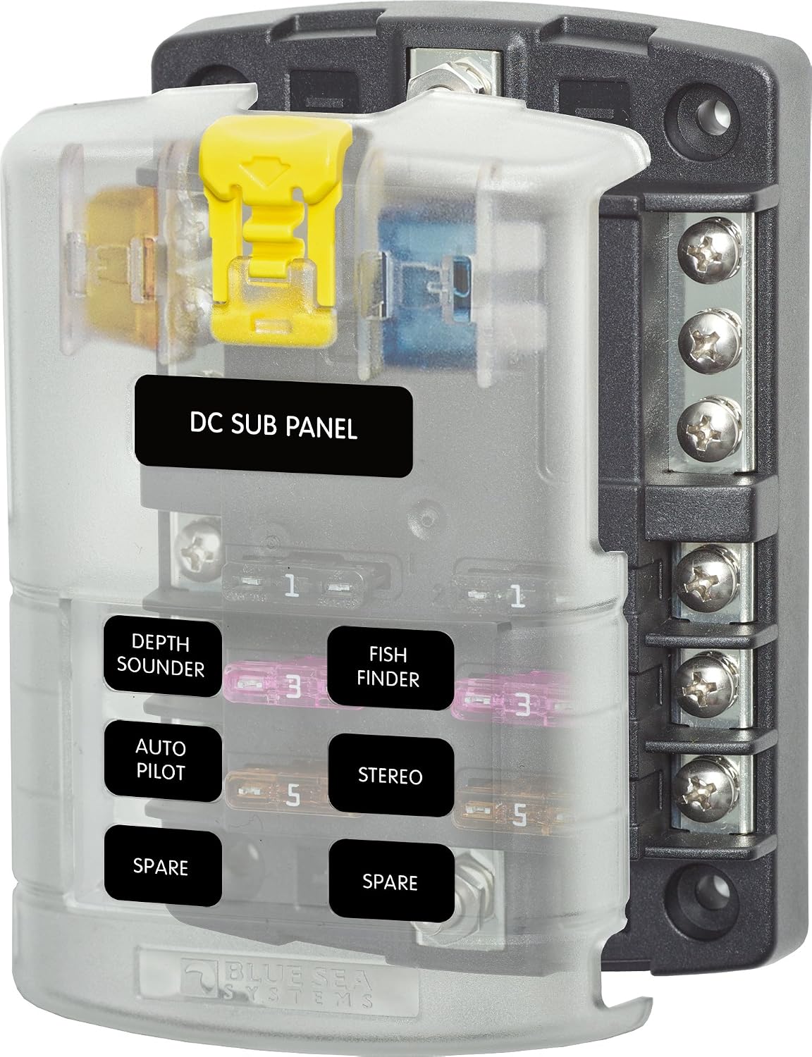

I've begun my holding tank monitor installation and into the wiring layout design. Probe and panel share the same power and ground. So while visualizing the to-be lazerette layout, I see that a PO wired an unfused 12v receptacle and hour meter directly to one of the batteries. I'm thinking rather than route power and ground all the way from the cabin control panel, install this surface mount branch panel in the laz and power the receptacle, meter and monitor from it. Should I supply power from the cabin control panel or from the battery?

You need to have a fuse between your source and the sub-panel. So from the cabin control panel (assuming fuses or breakers there) - that protects the feed to the small aux panel. Size that fuse/breaker on the wire size fed to the other panel.

I agree. Whether I tap into the main panel or from the battery, the supply needs to be fused.

Unless this is powering a device that must be a direct "always on" battery connection everything should ideally pass through the DC panel and the battery switch. A DC sub fuse panel should be appropriately named on the DC panel such as "DC Cockpit Feed" or "DC Sub Panel". Only the positive feed wire needs to run all the way back to the DC panel and the negative can be taken off the negative distribution bus close to the battery. Do not be tempted to connect the fuse panel to the engine for a negative return path as this can induce unwanted transients...

Thanks MS. I was undecided on the panel feed. I need to check, but I don't think the tank sensor needs continuous power. Maybe it does so the calibration holds? Otherwise I'll come off of the main panel with a new c/b. I have enough red tinned 10ga to reach the laz.

I ordered the new subpanel. Holy crap, the cost of my project wiring is adding up! I'm doing the mast lights as well.
Taking MS's advice on electrically putting the sub behind the main DC switch. I decided to go with a 6ga supply for it. I need to drill the main panel to add a new breaker to protect this wire to the sub. SBO has some with the same physical size and attachment pattern but 50A is the highest they offer. 6ga is rated for closer to 100A. Not that I need that much, I don't want to limit myself. I'm just running about 15' max. Any sources for a higher rated breaker that will fit?

100A would be just about the max ampacity for the maximum over current protection (OCP) sizing for the wire. This would also be for 105C wire..
In certain cases you can go to 150% of that, but level of OCP if that is necessary, it is always best to go up in wire size and stay at 100% of ABYC max ampacity.
That said you likely do not need OCP at 100% of 6GA wire.
We size wire first for minimum voltage drop (should be sized for 3%) then we address OCP. The max panel load should not exceed 80% of a fuses rating but preferably in the 50-70% range. Unless your DC sub panel has some serious motor starting loads then a 50A breaker should be plenty.
What is going to be on this sub panel?
What is currently feeding your main DC panel in terms of wire gauge?
What is the fuse/OCP that protects the main DC panel feeder?
What is the DC Main breaker on the panel sized at?

All good questions MS :)
I'll have to check all the c/b ratings, fuses and wire gauges this weekend. I wish I had an accurate wiring diagram. I'm creating one as I go. The subpanel won't have anything serious on it unless I do some deep rewiring. So far it will just be the new holding tank probe and display. the 12V receptacle that is currently unfused as well as an hour meter back there. I will probably add some switched stowage compartment lights in the future. I have 3 cockpit bins and 2 on the stepped transom. A bimini light would be nice someday too, since it stays up all season. that's it...for now. No startup loads.
