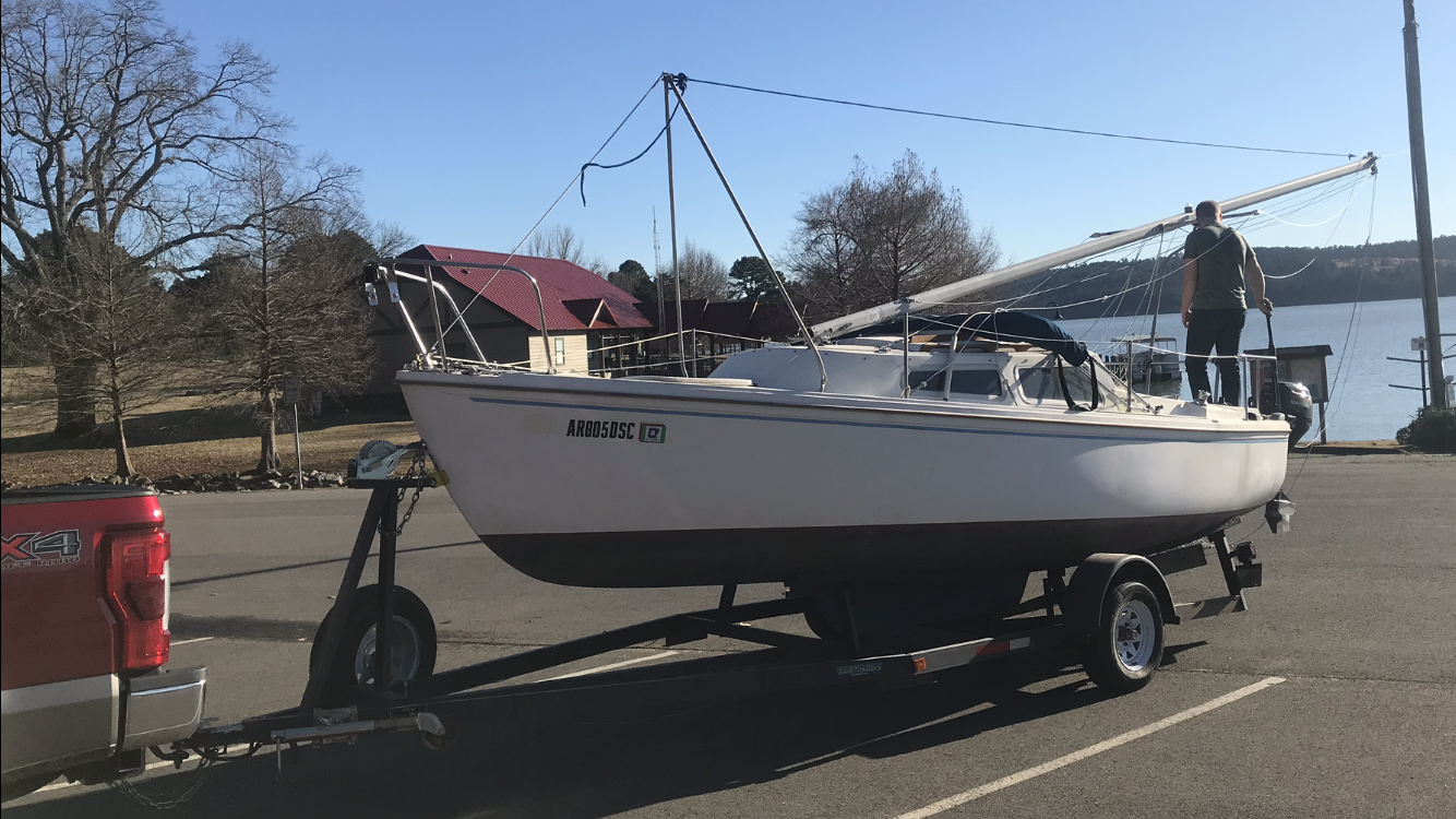

I just bought a 3500 lb electric winch with wireless remote with the idea of mounting it (preferably quick disconnect) to either my trailer or boat to aid in stepping the mast by myself. Initial thoughts were to weld an extension to the cannel iron at the front of the trailer where the existing boat winch is located, but that now seems possible, but impractical with the way it would have to be attached and still allow room for the crank handle on the boat winch to operate. Another idea is to build a quick disconnect platform on the bow pulpit rail. The question I have are:
1. Will the rail support the tension or will I damage it with putting the weight of the mast on it?
2. Can I do away with the A-frame that I currently use to step the mast.
3. Does anyone have any other ideas on how I could mount the winch?
Thanks for your input and ideas.

That looks great! And you were able to power the winch using your existing trailer wiring harness on your truck? Thank you very much for the information!
Sep 22, 2018
1,869
Hunter 216 Kingston
I didn’t try to use the wiring harness. Just used a 12 volt battery lawn mower battery.
I ‘extended’ the wiring to the remote so I can stand on the cockpit floor and have one hand on the remote and one on the mast.

1. It will damage the pulpit.
2. Only if you mount a mast on the front of the trailer that gives you the same or near the same angle to the mast with the headstay. The Hunter idea has a higher starting point at the stern than you do. Check out Catalina 250 mast raising systems.
3. Yes. The easiest would be to weld a channel to the front of your current bow stop just high enough to clear the bow and mount the winch on the channel.

I'm not going to be much help, but I'm curious why you want to do away with the a-frame. Looks like a pretty good setup as-is.

The view from here . The mast on our Oday 25 is heavy .Our setup is similar to yours .The major difference is that I used a double block and lead the line from the gin pole back to the winch on the mast for the mainsail halyard . This past fall I machined square adapter key that fits into the winch and has three sides that get clamped into the chuck of a 18 volt cordless drill. At any time of stepping or unstopping ,I can just cleat off the line and free a snagged stay or move the furling unit . I hope this helps.
The only thing I use the A-frame for is to step the mast. If I could get rid if the A-frame without significant additional strain on my winch/trailer, then I wouldn’t have to store it or carry it with me at all.

No seriously, with a winch that strong, what about a whole different approach. Mount it to a set of folding braces or a plywood board that straddles the step. On that is a pivoting sleave that craddles the mast a couple of feet above the base, then pull the base into the step with the winch. In other words, raise the mast directly, no halyard, no gin pole.
Or
If you have to connect the step first, it pulls directly on the mast just above the base from just ahead of the base.
There would be, of course, details to work out, but it's not hard to imagine something much more compact and portable.

@Will Gilmore I think you would rip the step out of the fiberglass. Imagine the force on the step if you put a block of wood 2' under the mast from the base and had the weight of 24' of mast past that point. I ran the numbers several years ago when I was thinking about putting a 4' hydraulic cylinder, on a mount in the companionway, going to a point 3' from the base of the mast. With a 30' mast it was like me sticking a 4' crowbar under the step and prying it off.

I like your idea of the winch with remote, although it strikes me that 3500lb is massive overkill and that 1000lb would be way more than adequate. Also, a small winch would work with your trailer hitch electrics. But, 3500lb is what you have. I can see why you wish to dispense with the A frame, because that effectively makes your whole winch idea impractical due to the big change in angle between winching point and A frame as you winch up the mast. I think you can indeed delete the A frame.
I have sailed a Cat 22 and it is of the same general size and type of boat as our O'Day 20. We have no A frame, and use our trailer winch strap connected to the forestay. The necessary first step is to have a stern mast support sufficiently high to make a straight winch pull possible. Our stern support is 8' above the cockpit floor/sole. The mast weighs very little and I am only lifting half of it at first, so an initial lift, to rest on the stern support, is quick and simple. Next I stand on the cabin roof and stabilise the mast as it is winched up. Near vertical the shrouds take over of course to stabilise it laterally. The line of the winch strap, in the absence of an A frame, passes under the bow pulpit and only pushes lightly up against the pulpit for the last few degrees of angle.
At the moment this is a two person job, because I cannot operate the winch and handle the mast simultaneously. With your remote winch idea it would become an easy one person job. Mounting point for the winch? My guess would be the rear end of the truck bed, or on the truck bumper. The loads would not be high.
Of course doing it our way you have an 8' mast support to store somewhere instead of an A frame, so no gain there, but I made our support so it telescopes down to 5', and it stores in the pickup bed.

I appreciate your point. I wasn't thinking of attaching it to the step, but holding it down is the big engineering issue. "Straddling" the step was just where I would place it to get it to work. I think it can be done, but I haven't worked it up. Just shooting some thoughts out that I think might hold promise. After all, the winch itself can handle 3500 pounds of force. I'm just thinking something can be built to resist the leverage.
