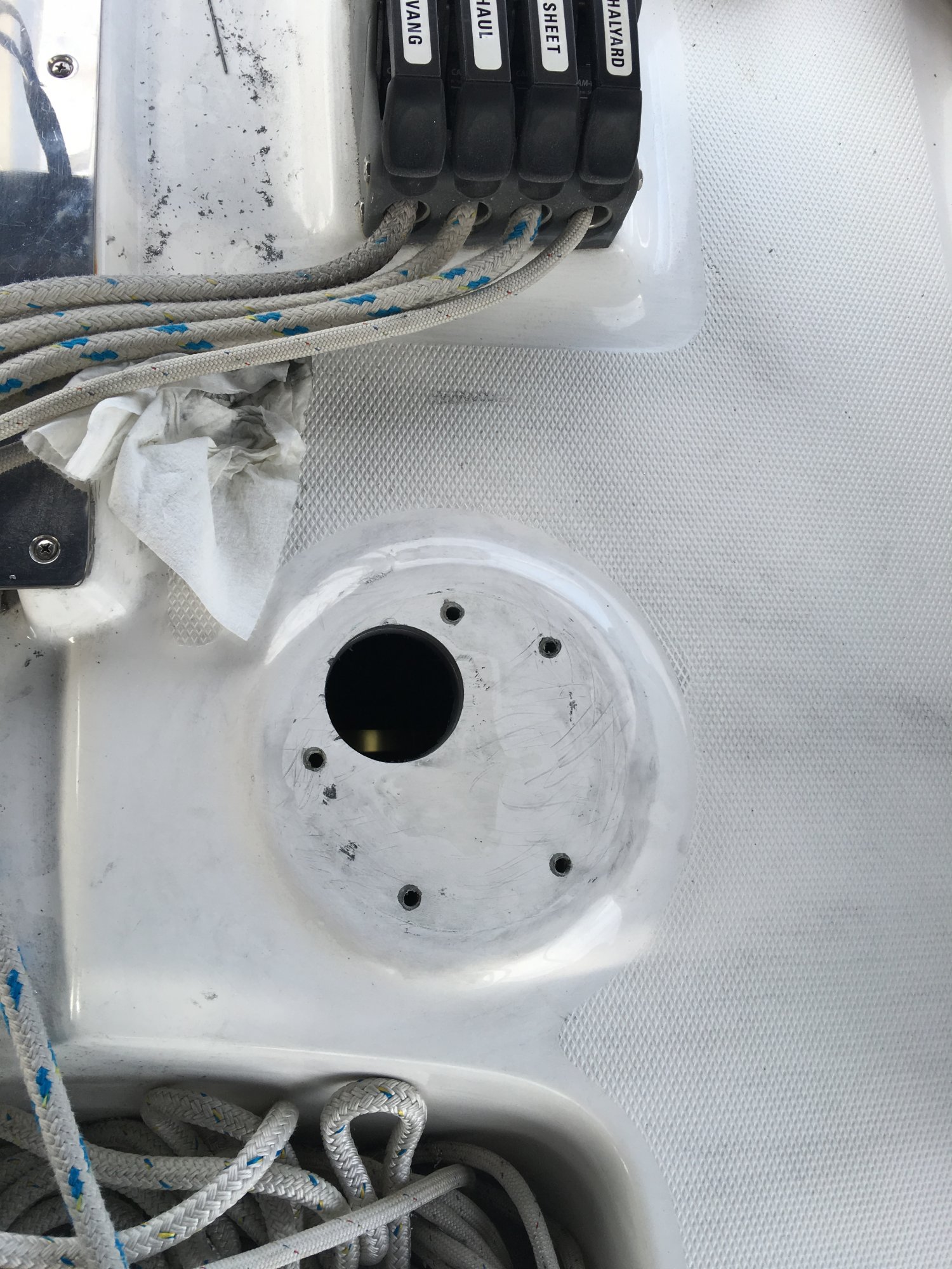

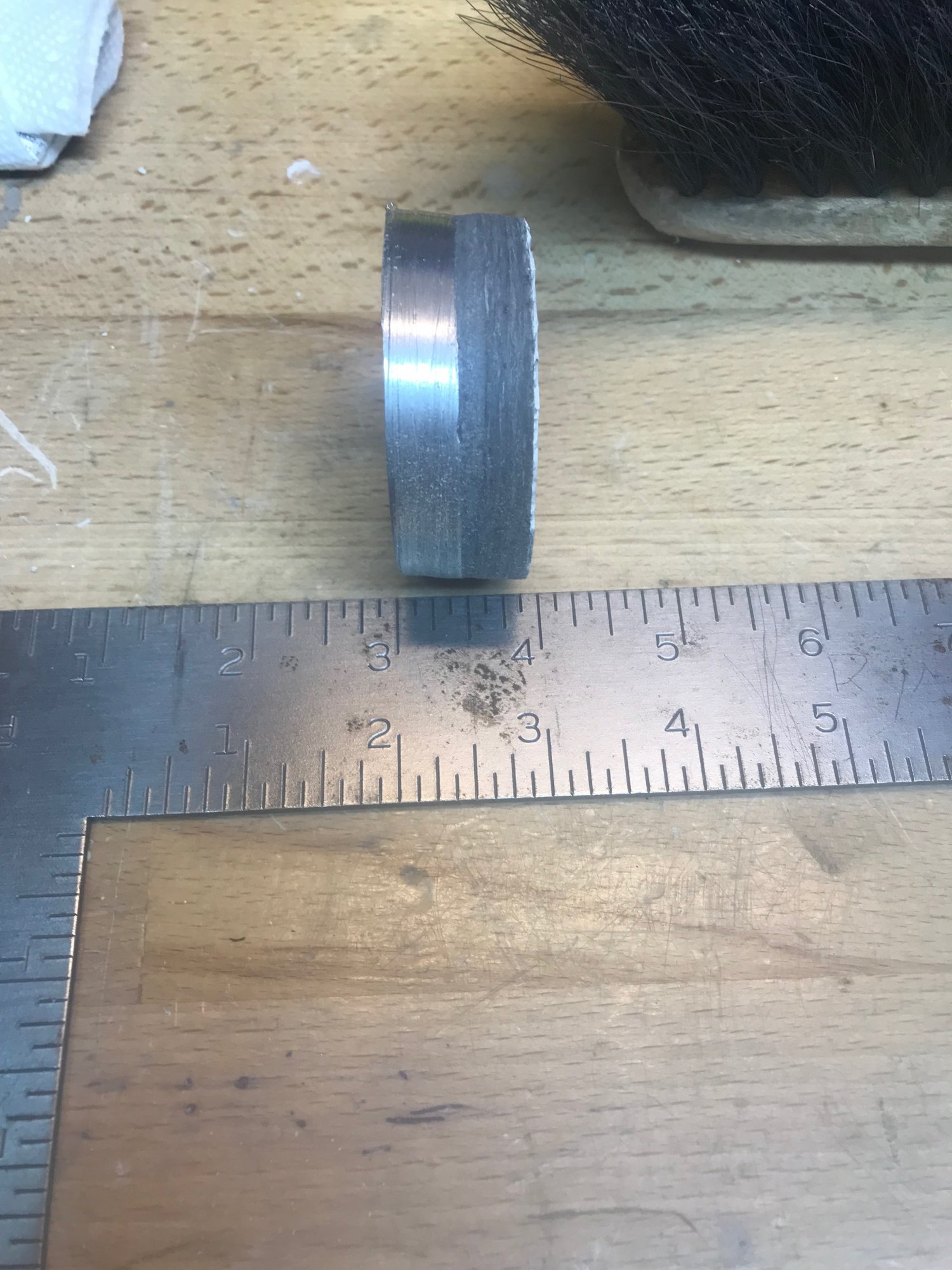

I installed one in cockpit on our H41DS. Not quite the same but the installation process is probably pretty close. It is a Lewmar 45 and I love it. I did have a ewinch but id did not care for it. I raise and lower dinghy with it and use it to go up the mast. I have a remote on it and can control it while dealing with the dingy. Makes life much easier and one of the additions to the boat that is in my top 2 (along with a bow thruster). Not that difficult of an install. The hardest part was drilling the hole in the cabin top. Lots of aluminum and thick! Here is a picture of the plug!
