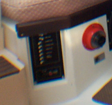

If your panel is similar to the attached photo of my old '81 H27, then the "switch" is actually your circuit breaker (CB) for the one and only 110VAC circuit on the boat. It feeds one receptacle in the galley and another in the head/lav area. This was how the stock H27 was shipped from the factory.
The "reversed polarity" applies to a RED neon light next to the CB which indicates whether the incoming shore power is correct. If the neon is missing there may be a hole where it was installed or someone may have installed a blank cover over the hole.
Sorry for the picture quality as I had to zoom in and crop to try and get detail.
