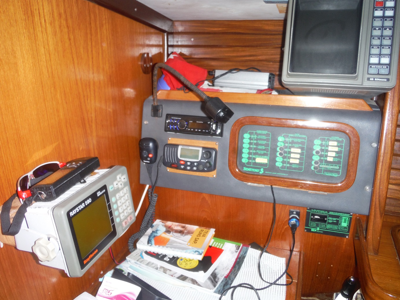

Hi,
Thanks for the many replies.
I attached a picture of the panel.
I know understand that there is a difference between a fuse and a circuit breaker.
The glass fuse is located on the side of the panel (after you pull it). There is only one like that.
I'll get to the boat this weekend and take a picture + try the tips given above and try to figure out if its for a specific device (I think not) of for the entire panel.
thx
Yoram

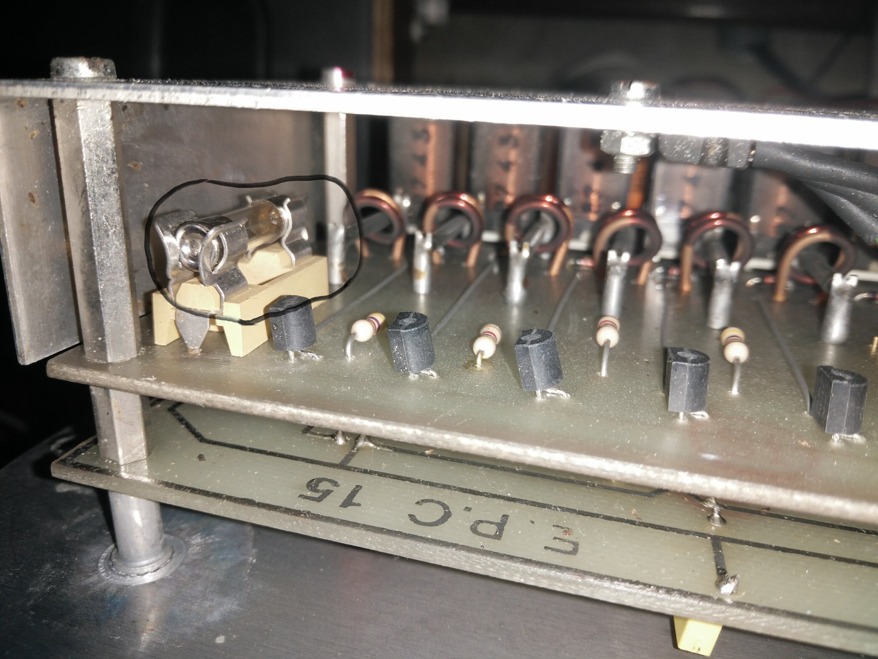

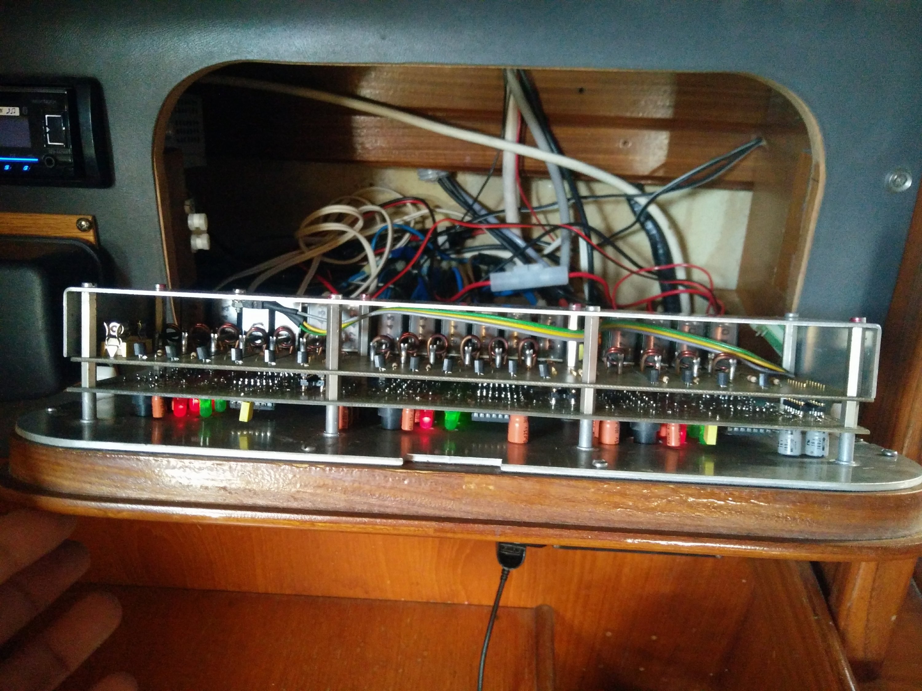

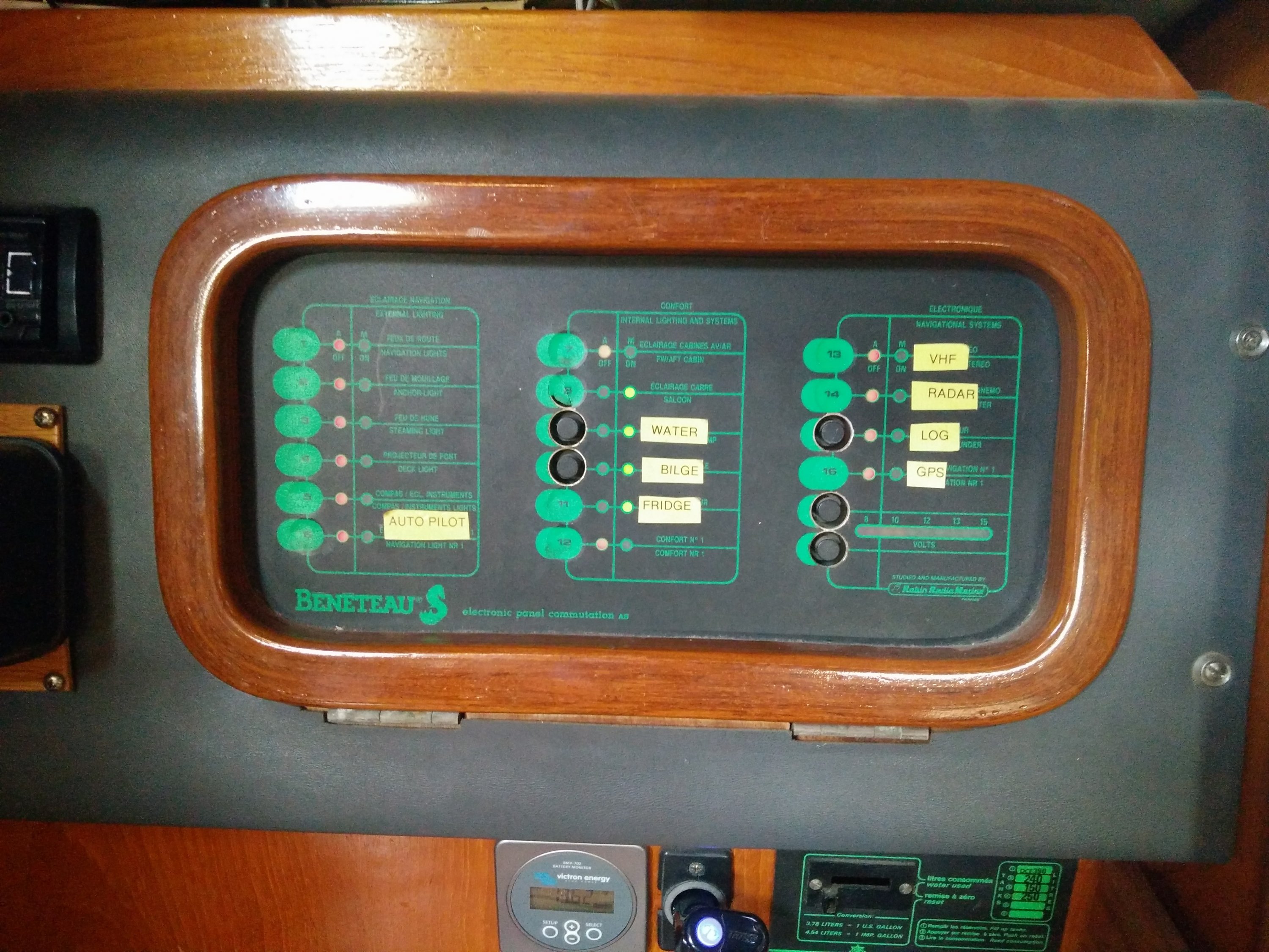

Hi again,
I attached 3 pics of the panel and the fuse in the panel.
The panel has three columns:
Navigation - all the exterior lights and the auto pilot
Comfort - interior lights, bilge pump, fridge, water pumps, shower pumps
Electronic - VHF, log, radar, GPS
When the fuse is pulled out only the Electronic devices work (VHF, log, radar, GPS).
What kind of fuse should I buy?
Thanks in advance
Yoram

There is no way that your nav lights, auto-pilot, pumps and interior lighting can all be powered through a 5Amp fuse, so it must be a fuse specific to the "electronic panel" controller, not the actual device power supply. That said, I have never seen a panel like that, must be European spec.
May 20, 2016
3,015
That fuse probably controls the panel - not the individual circuits in the boat. To find out the size - just pop it out - it will be stamped into the top or bottom silver bands. You also need the letters that specify how fast the fuse blows.
