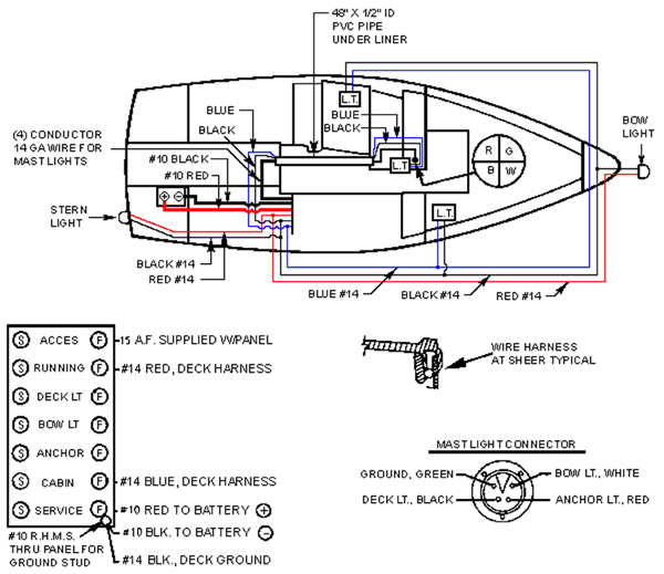

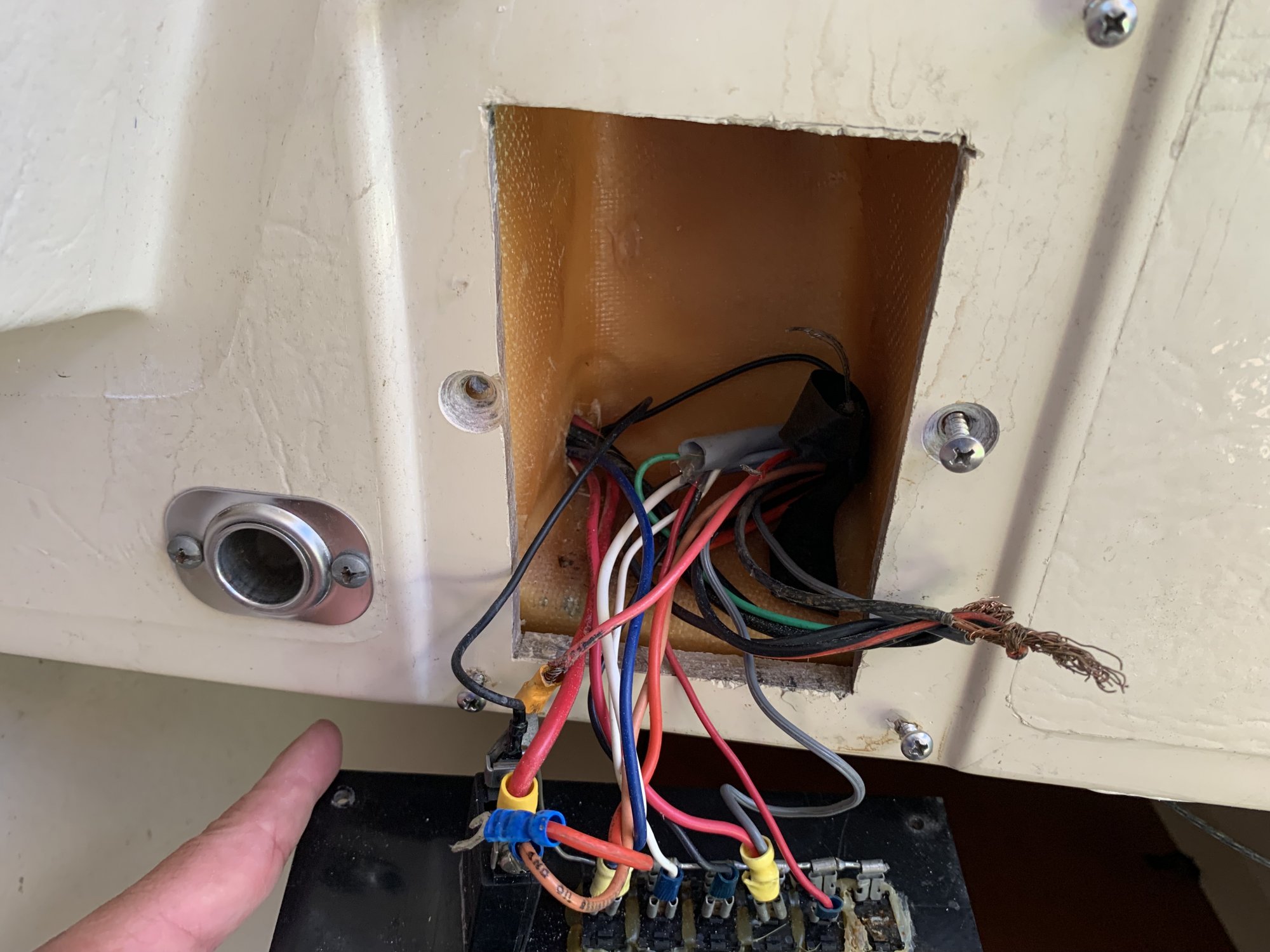

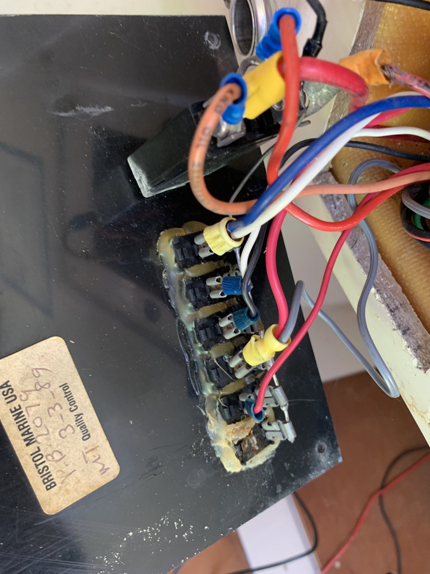

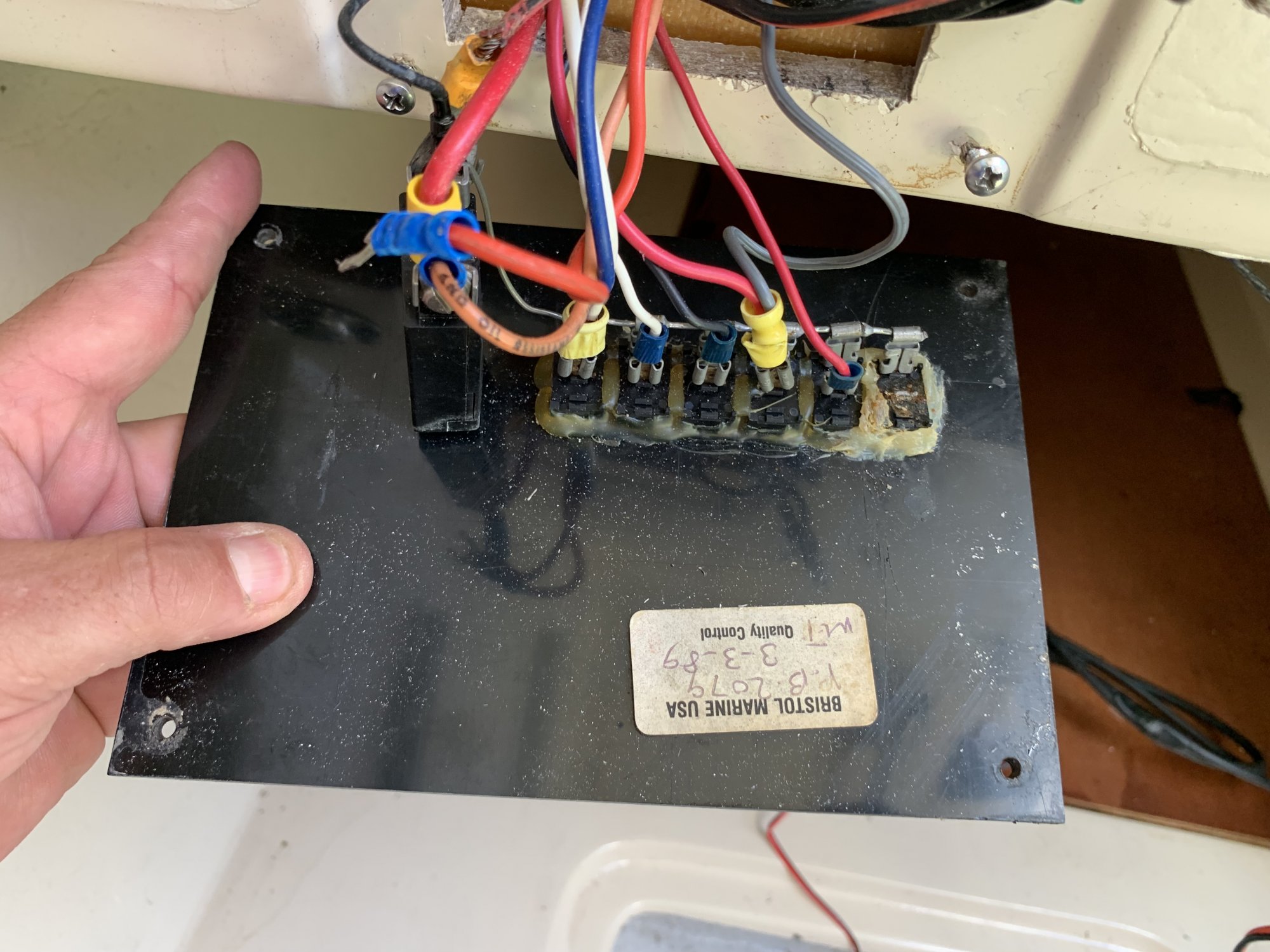

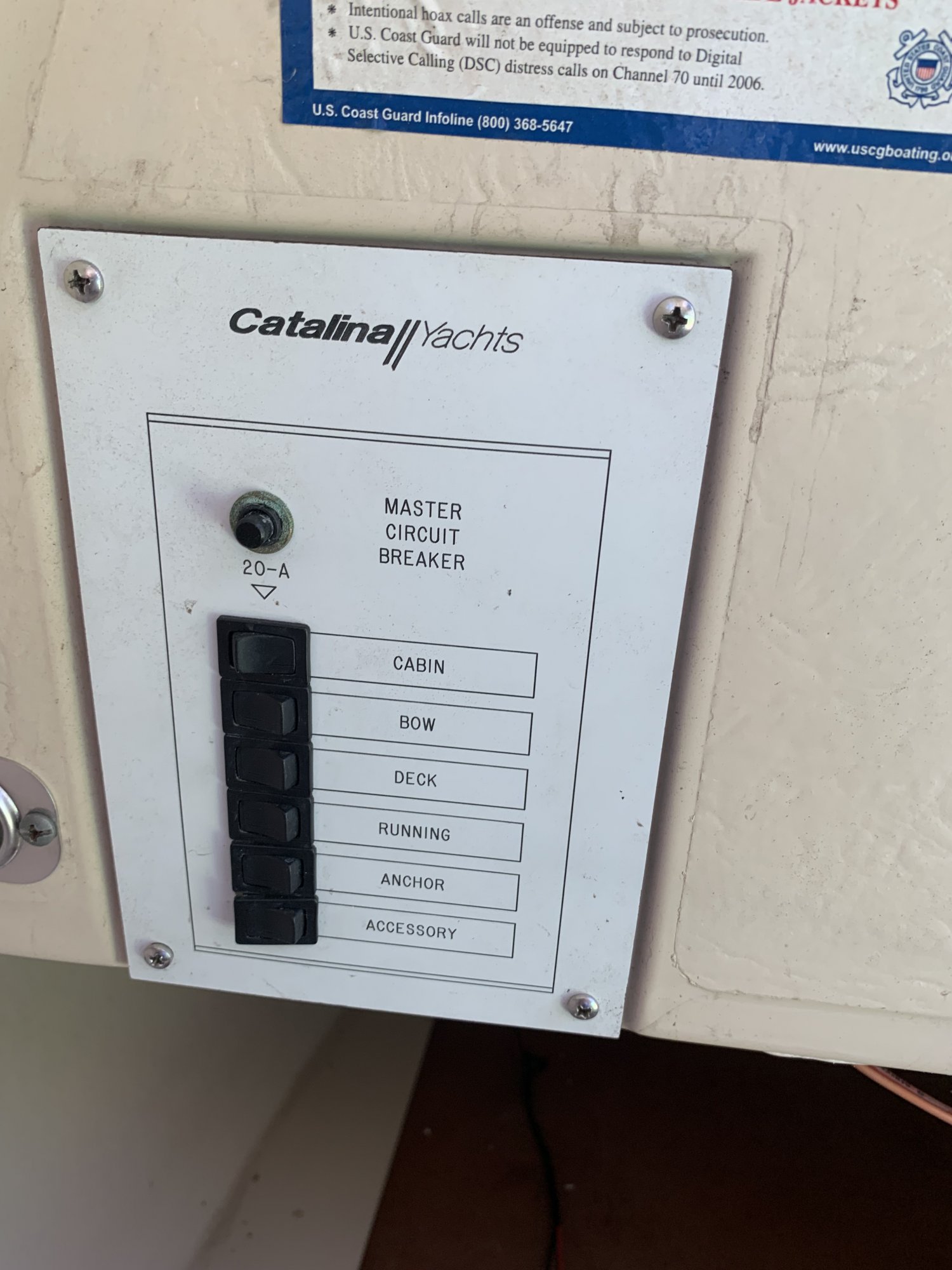

I have an 89 wing keel and the electric is looking OLD. Does anyone have any videos or simple diagrams for one to rewire the boat I have the original lights etc. The previous owner cut the wires when he was trying to redo the mast lights. There is just wires in the molded sides and top. I'm wanting to do it right. I have zero electric skills in my past.
