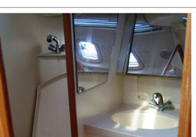

Hi All: Location on a H386??
sail sfbay . Feb 21, 2013 4,638 Hunter 46 Point Richmond, CA Aug 26, 2021 #2 Behind the removable panel behind the vanity sink faucet is where I found the solenoid valve on my Hunter 386 when I replaced it. Its a "plug and play". If I recall this was the part Amazon.com : Jabsco 37038-1012, Marine Toilet Repair, Head Solenoid / Anti-Syphon Valve, 12 Volt : Boating Equipment : Sports & Outdoors Last edited: Aug 26, 2021
