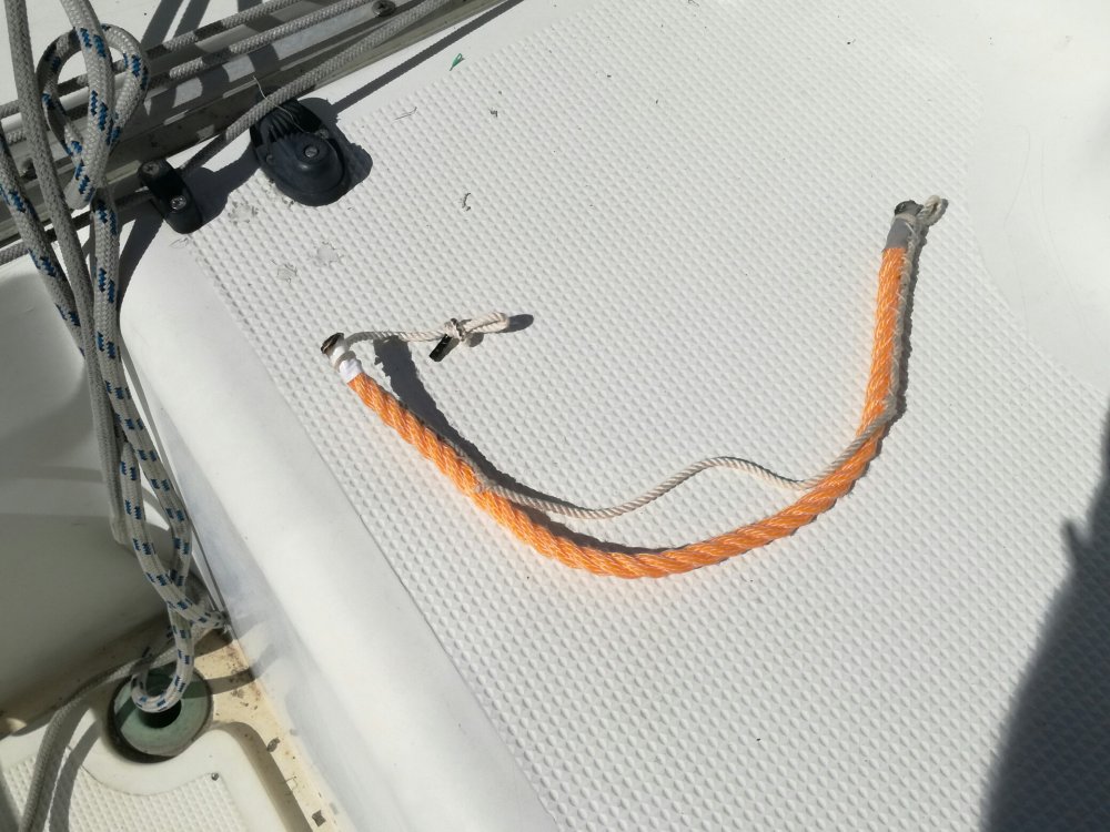

To hoist the main I go to the mast, heave down on the halyard where it exits the mast, place a wedge in the organizer turning block. Then go back to the cockpit , haul up the last 50 cm and winch tight. The sail has a boltrope and it is OLD. I found that it was getting harder and harder to haul up, so I made up a track cleaner. Pic 1

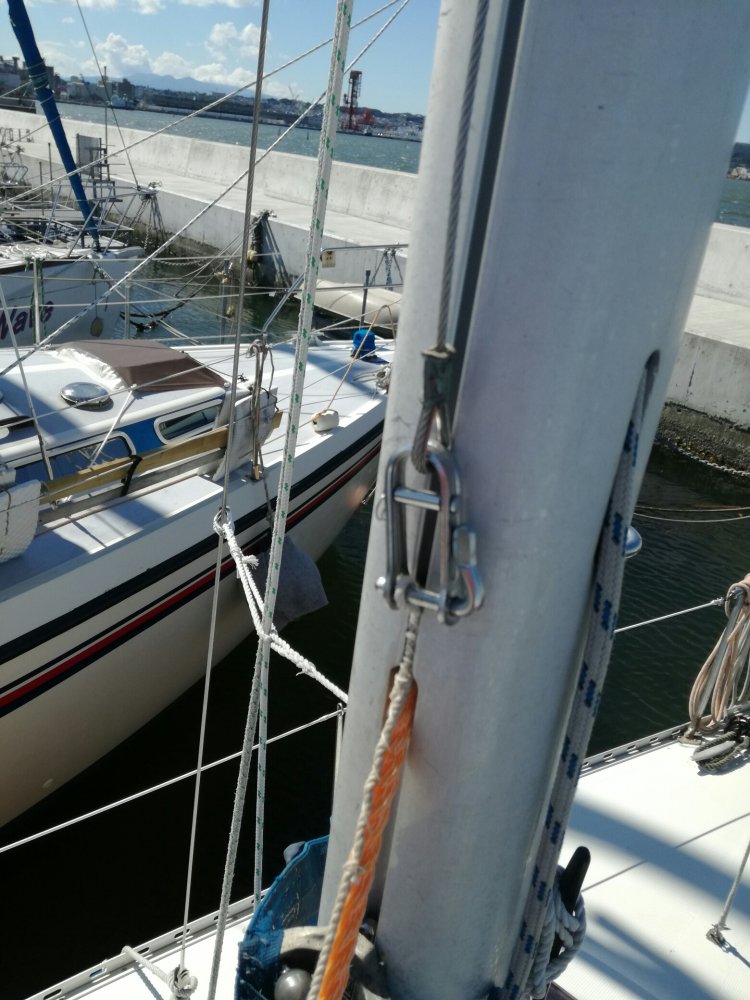

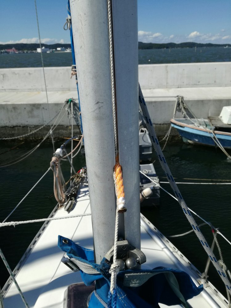

This is 30cm of (rough) nylon rope with a tether whipped to it. The tether ends just above the rope on one end and extends down about 5 cm or so on the lower end. The main halyard is connected to the short end (Pic 2) and a light downhaul to the other( pic 3). The rope is liberally sprayed with silicone grease then fed into the track.
I hauled up and down a couple of times. Removed it and resprayed and repeated.
It WORKS!!!! The main now glides up. Will work with slugs too. Gary
