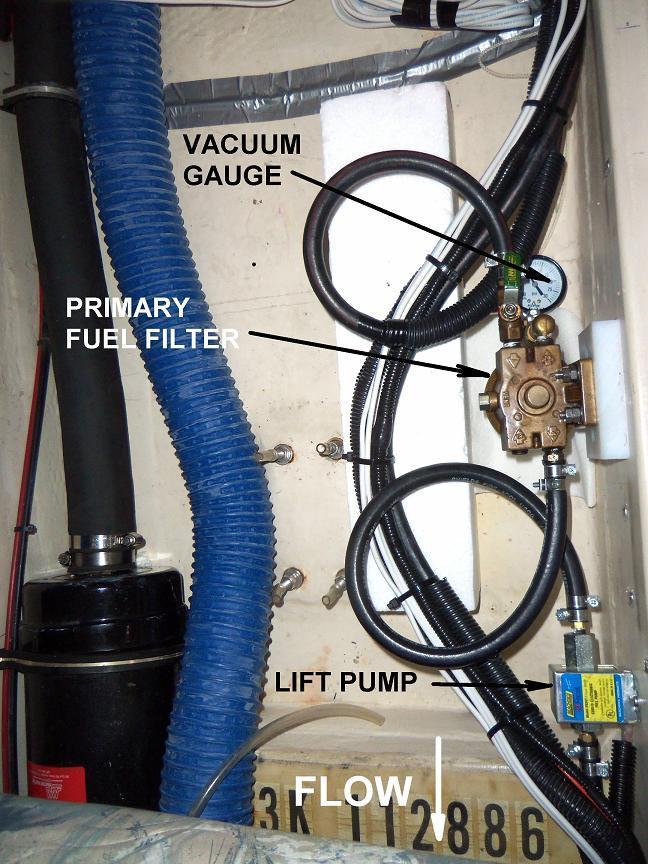

Speaking as an H-310 owner from new, the electric pump was installed by the previous owner. Get the ID off the pump and search for it on the net. I installed this one in my fuel system after one too many hassles with my cam operated fuel pump:
If your elec. pump is the correct selection, it will NOT shut off the gravity flow of fuel with no power. This allows your engine to pull fuel even if the elec. pump fails during operation. The isolation valve before the filter means you never have to go back to the tank when working on the filter, pump, or whatever you've got in there.

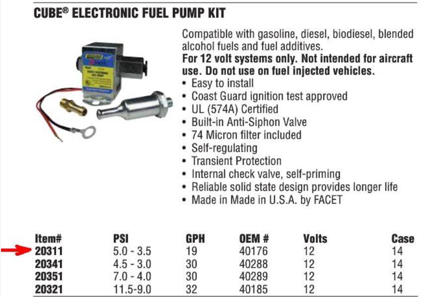

...................... which depends on the make of the pump. The Facet Cube pumps runs at a constant speed and bypasses fuel to control the pressure.
23,392
Ralph.
What about the Facet statement “Do not use on fuel injected vehicles”?
Does the pump provide a bypass if the pump is off?
According to the Yanmar dealer here in Vancouver, they've been installing them in boats for years. I bought it from them on their recommendation and never seen a hiccup since. Go figure.
When the ignition key is first turned on, the HP diesel pump is dead ended (OFF) and the pump continues to click away. Got to be a by-pass or else something in there is not too, too, insistant with its stroke:rolleyes:. I remember leaving it running with a stopped engine for several minutes when I first installed it to make sure it had no problem dead ending. No overheating, nada.
Not a clue as to what it means "not to use on a fuel injected engine." Does it make any difference if the engine is carbeuretted ? ? ? ? The fuel pump is still dead ended if you sit there without starting the engine.

Only thing I can think of is many gasoline FI systems run the fuel in a loop. Whatever pressure is above regulator pressure is looped back to the tank. This type of system would make a lift pump run at full volume constantly and maybe that would make their pump unhappy.

The Facet wording to not use on fuel injected engines is about gasoline electronic fuel injected engines where the required fuel pressure is a lot higher than the Facet produces.. A diesel only needs fuel to be delivered at a slight positive pressure at the HP pump to function.. The Facet makes enough pressure for that.
