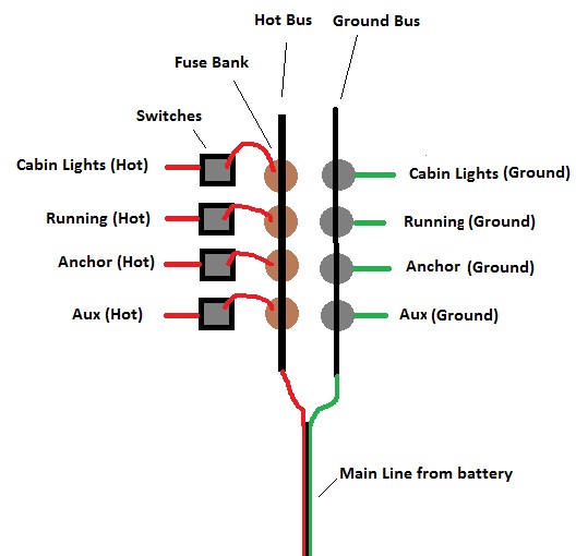

I've had a graduate level electronics course when I was in graduate school, I've built power supplies and A/D converters etc. .... so I know what end of the soldering iron to hold but this one has me stumped.. If you have any ideas PLEASE HELP.....I've attached a diagram of how I wired my panel in my boat.
Here is my story. Yesterday I want out to check the battery in the boat (it was good) and I tested all of the switches and lights. Everything worked ... but... I noticed that my 2-season old LED bow light was only showing red. The green light was so dim you could hardly see it. It is an Atwood brand and Walmart carries the exact same one (great, I can use the same base) so I unscrewed the one I had from it's base and installed a new one over the same base. Seemed like my luck was holding since I didn't have to re-bed the light... Wired it red-to-red and black-to-black and then things got strange...
None of my switches work now. No juice at all. I tested the voltage at the hot and ground bus and I had 13V. SO LONG AS ALL OF THE SWITCHES WERE OPEN. As soon as I throw a switch (any switch) the voltage drops to zero between the the buses and I get no juice through the circuits to the devices.
I don't get it. Even if the new bow light was shorted, how could it effect the other lines? And if it is not the new bow light, then how did I generate a short in ALL of my lines?
There wasn't an electric storm last night so I fairly certain my boat was not struck by lightning.
I ran out of day light today but tomorrow I'm going to disconnect the new bow light and see if the other lines start working again... and if that works, I still don't get how a short in the nav. light line could effect the other lines if the nav. light switch was open.
If you have any ideas, please share....
