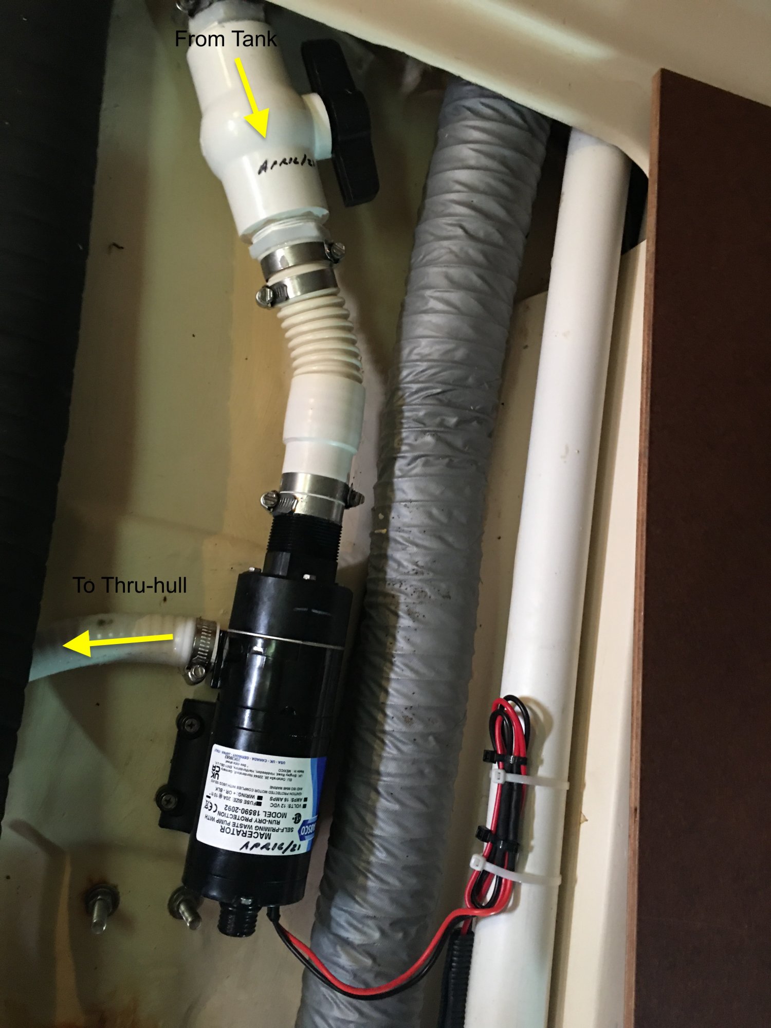

Thank you Peggie, I do not believe that is the case but will confirm when I go down to the boat later today and post a pic of the installation.

Thanks Peggie,
I can confirm the following based on my visit to the boat earlier today (pls see attached pic):
1. Tank is no greater than half full;
2. Macerator pump is installed correctly; and
3. Macerator pump wiring is correct.
This being the case, if there is a partial blockage between the macerator and thru-hull, is there any possibility that is is contributing to a vacuum in the tank that is forcing effluent through the vent when the macerator is turned on? Any other ideas?

1. How do you know that the tank is no greater than half full? - Are you are relying on a tank level indicator that may be unreliable?
2. Macerator is installed correctly - that looks right
3. Macerator pump wiring is correct? While your red may be hooked to the red and black to the black did you actually probe with a voltmeter to check that the red supply wire from the dc system is actually positive?
A couple other things to check
4. Is the white in line valve really open? - Yes the handle says its open but did the ball really move to open?
5. At your thru-hull, are you sure the ball is actually moved to the open position or are you relying only on the handle says its open - THIS HAPPENED TO ME - (not yelling, just for emphasis) the valve shaft didn't actually turn the ball so I thought it was open when in reality it was closed (I had to replace the thru-hull)
6. Is it even remotely possible that the macerator pump is internally wired backward? Stranger things have happened. Is this the first time that you have used the macerator since you installed it?
[/QUOTE]
Thank you for helping sort through the various contributors to the problem Smokey.
To answer your questions:
1. It is possible to see how full the tank is i.e. unless it is completely full or empty, using a flash light. Unfortunately, the tank level indicator is quite unreliable.
3. Every indication is that the wiring is OEM and therefore, I have assumed as I connected red to red and black to black, this is not the issue. However, I will check with a multimeter has you suggest.
4. The in-valve is definitely open, it was one of the first things I checked.
5. All the thru-hull valves were checked when the boat was lifted earlier this year.
6. It is certainly possible that the macerator itself is incorrectly wired internally. Other than testing it during installation, this is the first time we have used it to any extent. I have a spare (older generation) pump I might try.
Thanks again Smokey.

@LVGS How hard is it to turn the overboard discharge thru-hull valve handle? When mine failed it was very easy to turn the handle because the shaft had sheared and the handle was not really rotating the ball itself.
After you check the voltage for the input from the boats dc panel:
Can you go over the side, find the correct thru-hull opening underwater and with the valve open, attempt to put something up the hole to make sure it is actually open?
Probably not likely that the pump is internally wired wrong but outside of the box thinking only. If you are going to think about replacing the pump, it might be messy, but prudent, to check the current pump by disconnecting the input and output hose, putting a hose from the tank side in a bucket of water and bumping the macerator motor into a large bucket to see if its actually pumping in the right direction. This is a two person job so you only bump the motor very briefly. Otherwise its a reall mess:poop:
I still don't see how a blocked outlet would pressurize the tank and cause effluent to come out of the vent since the pump should just operate at shut off head and pressurize the line from the macerator output to the thru-hull.

Smokey73 may have hit on the answer: If this is the first time you've used that macerator since you installed it, it's indeed possible that the motor could have been installed backward or internally wired backward, especially if it's a Jabsco.
Most of you are aware that ITT spun Jabsco off to a company called Xylem Flow Control about 10 years ago. What you may not know is that while Xylem is a US company, they do -0- manufacturing in the US...it's all done in 3 locations: the UK, China and Mexico...and Mexico is where everything Jabsco makes that's sold in the US is made, using materials and components sourced from China and other Asian countries. As a result, the quality of Jabsco equipment (which never has been TOP rated, but decent) has deteriorated significantly.
So I'd try another macerator pump (if you have to buy one instead of borrowing one, go with a Johnson Pump this time...pretty much identical to the Jabsco, but much higher quality for close the to same price). Hopefully you can still return this one for an exchange.
Afterthought: Have you tried pumping out instead of dumping? That would be quickest way to determine whether there are any blockages in the discharge line.
