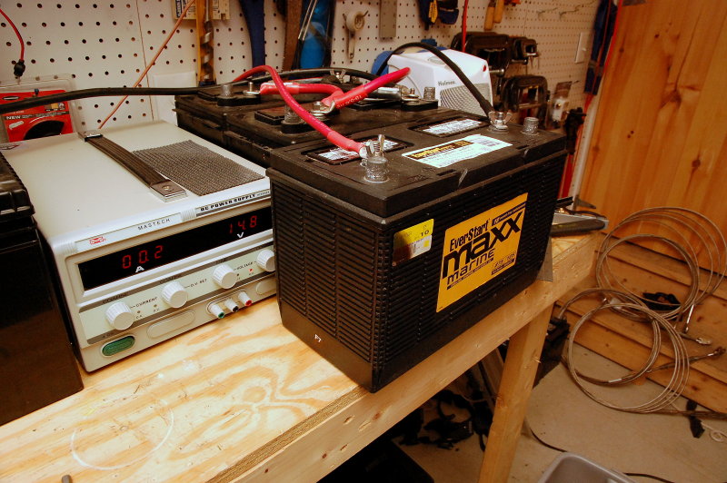

On December 11, 2012 I charged this deep cycle battery, that had just ended its sixth year of use, using my bench top DC power supply. I charged the battery to 14.8V and 0.2A of "accepted current" which essentially means this battery was full.
December 11, 2012 @ 10 Minutes

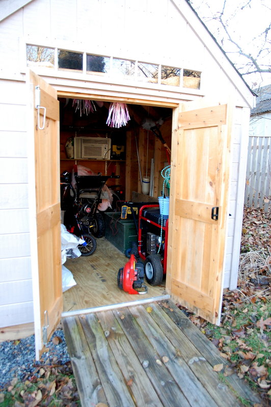

I then carried the battery out to my garden shed, which is unheated, to mimic a boat during the winter here in Maine. I suppose I could have just carried it up the ladder, and into my boat, but no sense in breaking my back, the temps are the same.
At this point I took my first open circuit voltage reading about ten minutes after discontinuing the charge. It read 13.77V and represents a "surface charge" that has not yet dissipated.
December 11, 2012 - Shed
This is a shot of the shed with the battery sitting on the green box. The temps in here mimic that of our boat quite well.

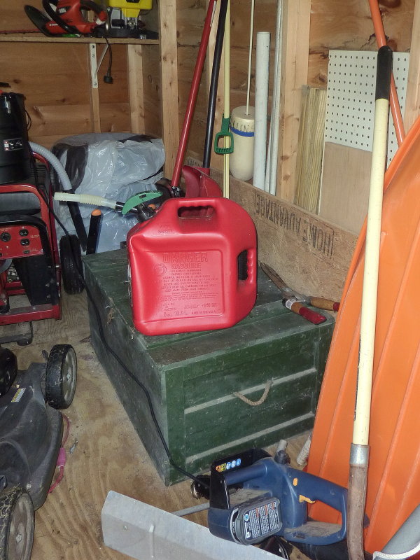

This morning, September 9th 2013, I walked into the shed and realized a gas can had been set in front of my "experiment" and I had totally forgotten about it. Arghhh that damn ADHD.......:cussing:
What this means is the battery sat from Dec 11, 2012 to September 9, 2013 100% un-charged!!!!!!!!!!!!!! Doh'.......... :doh:

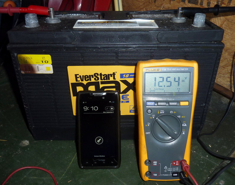

After seeing my battery sitting there I immediately went to the barn and grabbed my DVM. I was honestly figuring this battery was a goner. It tested with an open circuit voltage of 12.54V! :eek: This after sitting in a freezing cold then blistering hot shed throughout an entire Maine winter and hot summer.
I was a total disbeliever at the resting OCV of this flooded battery that had sat 100% uncharged for nearly 8 months. I grabbed my refractometer and performed specific gravity checks on each cell. To my amazement they all agreed, meaning each cell was still well balanced, and all agreed with the DVM about the SOC..
