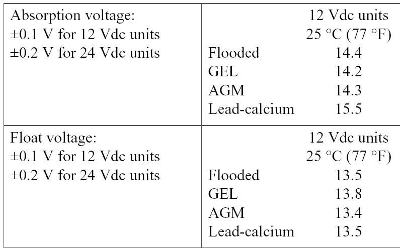

Charging voltages for AGM batteries are are very close to those of flooded batteries.

A fully charged wet battery is about 12.6 or higher and 50% is about 12.1 volts. Trojan's chart for flooded is below.
Also below is the charge voltages on a common marine charger (xantrex TrueCharge2). Note there is a .1 volt difference between AGM and flooded. Note also that the charger is accurate by +/- .1 volts.
