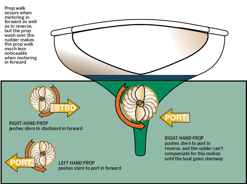

Do others with this boat get vibration in the wheel when under power and a pretty severe tendency to turn left (port)
It doesn't do this under sail.

I've never owned a Catalina but my H356 would sometimes veer to one side under power but not sail. I assume it had something to due with the prop rotation but never learned why it occurred sometimes and not others. There was nothing wrong with the steering.

2-blade props are known for causing pull - there's a pulse when the blades line up with the rudder. 3-blades smooths it out. Wheel vibration is likely from the engine/drive-train.
Bingo.
In addition to the prop rotation causing the stern to turn, when it hits the rudder it moves across the rudder faster on one side than the other. It will cause the wheel to turn.
The direction is dependent on the prop direction of rotation.
