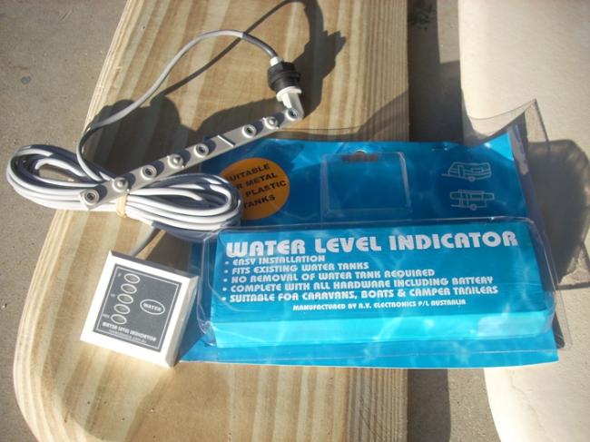

One of my biggest gripes with our Hunter 260 was the impossible access to figure out the on-board water level. I shopped around for typical marine gauges which were all pricey, tinkered with floats and such and then ran across a sweet little RV water tank gauge for $50 that installs easy and works like a charm. Here's the web address. www.rvelectronics.com The 20gal plastic on-board tank is about 1' deep so I drilled a hole in the side near the top, inserted the probe and gently tightened the fitting which sealed very nicely, slipped the wire back to the galley sink, plugged in the gauge and wa-la. In less than 30mins I'm in the know with no more guessing. One of the easiest mods I've done to the boat. Good luck and keep cool. Michael The whole kit.

several types of guages
The one mentioned of course is drilling into the tank. The second is a tape added to the side of the tank with the lead wire running to the tank indicator with the monitor having to be calibrated which in some is difficult and go out. The third which i like is the Sensa A tank which has four photo cells that attach to the tank and the wires are run to the tank indicator and does not need to be callibrated. This one is the best rated by Practical Sailor. Yes it may cost but sure is a humm dinger.
