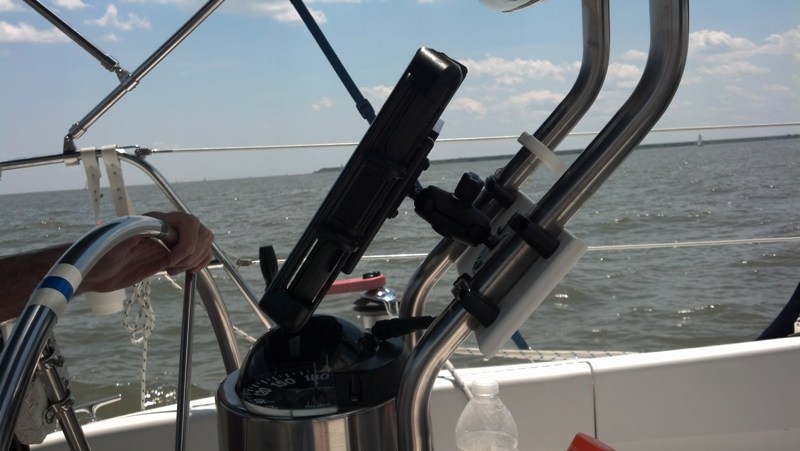

Side view Scanstrut ROKK mount & iPad Air... The ROKK mount will even fit at the rounded part of the pedestal guard.
Daylight visibility, overheating in the direct sun & battery life of the iPad still sucks, but it is nice to have it firmly mounted. This iPad Air is in a Lifeproof Nuud case SKU: 1901-01 with the Lifeproof Mounting Cradle SKU: 1935. The Scanstrut ROKK uses the AMPS adapter plate to connect to the LifeProof mount.

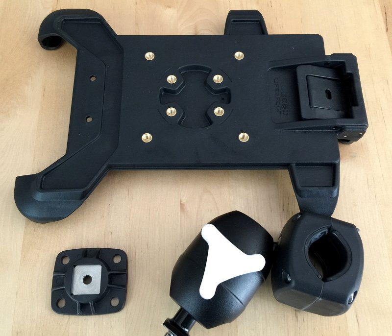

LifeProof Mounting Cradle with AMPS standard bolt pattern:

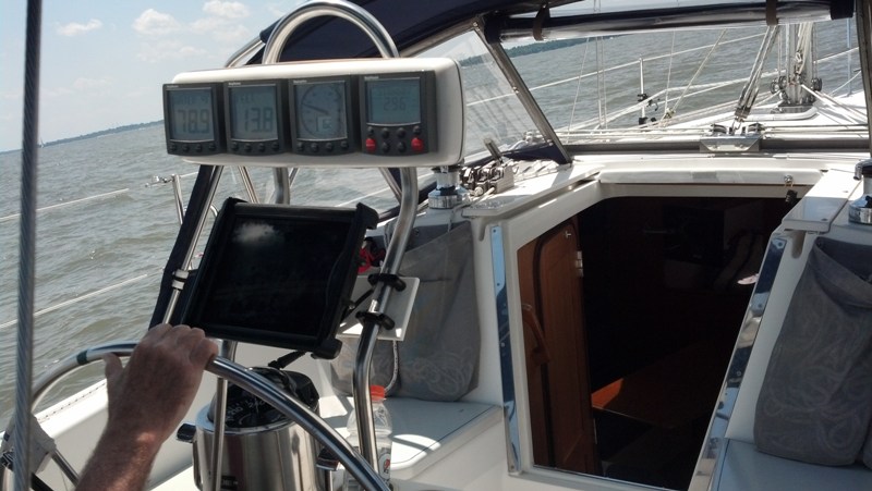

This is a great mount for the iPad and when not charging it remains water proof. The mount is solid as a rock and can be bumped and nudged without knocking the iPad out of the mounting cradle.

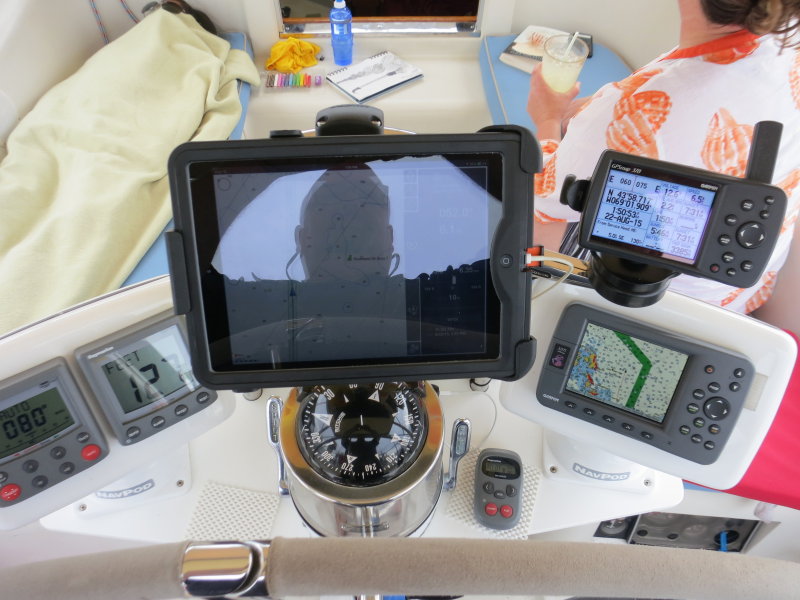

MS... and therein lies the rub. The picture of all the toys shows an almost perfect contrast to everything, even the remote, and then there's the ipad, acting just like a mirror. You are right about the overheating, we've had ours down below streaming some music, out of the sun and it has shut itself off. Not a very good scenario if it were being used for nav purposes.

? I can see mine just fine with the screen on full bright. It is off in the pic.
I'm sitting in my cockpit with mine now and have to use a towel over it/me to read/type.
Brightness level on full. I must be. Doing something wrong.
